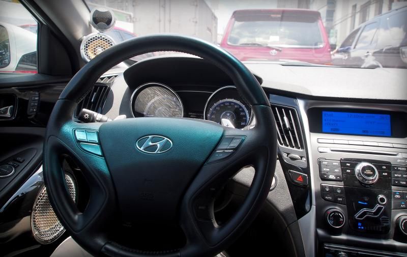

    That's probably the head unit's "mother" board na mismo. In theory, it might just be the CD mechanism if lagi bad disc yun CD but since the SD slot is also affected, I'll suspect that it's the board itself.
    Hindi ba pasok sa warranty ni Hyundai PH? Since that's going to cost a lot for repairs (almost brand new cost na yan)
    Ang hassle pala. Ang hirap ipagawa sa casa since wala talagang oras. Alam mo naman... Schedule pa ng appointment, ang haba pa ng pila, makipagkulit-kulitan pa sa mga warranty personnel nila and so on and so forth.
    But then again, bat natatanggap pa ang GPS SD card? Kung sira yan diba dapat pati yan di nababasa?
    Marupok ba talaga tong mga OEM AVT head units?

    It's not the SD card mechanism but rather how it reads the files. GPS data is handled by another decoder so it's unaffected while turning digital audio files like .wav, .mp3, etc. to something that can be read by your head unit lies with the DAC chip on the board and that might be the one which is defective. The reason why it can't decode is most probably the culprit of your error message of "bad files". Problem is, your DAC chip is central to the head unit's operations and it's like changing the CPU unit of your computer. Most manufacturers would rather say that you replace the entire board instead since what they usually get are finished-units na with their board assembly being outsourced to low-cost production countries like Taiwan.
    That's my guess anyway.
