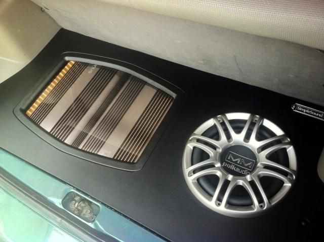

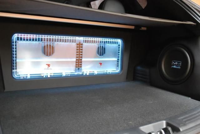

    Sometimes, you just need to be more creative in the mounting of the subwoofer. Problem is custom fiberglass fabrication is expensive since nobody who's good at them will price their services low.. (market supply and demand lang yan) so think about your wallet first before pursuing any project.
    But for inspiration, I'll share some of my friends (which I don't think will complain if I use their pictures) who done their project installs without compromising the trunk/3rd row. Both installations are done by SimpleSounds in Antipolo coincidentally.
    Monch's setup is probably my all-time favorite. Installed at the trunk of a Hyundai Tucson. The amplifier wall doesn't eat up too much space while the subwoofer enclosure is flush-mounted on the side.
    The other one is Dom's setup inside a Kia Pride. The key here is that the subwoofer enclosure is a small sealed cylindrical so that the installer can mount it at the center cavity of the spare tire.
    Want an easier mounting? Go for smaller subwoofers. A 8" subwoofer will be a whole lot easier to install in tight spaces versus a 12". However, creation of bass is still air displacement so the bigger diameter cone will still win out if we talk about performance. So balance accordingly.
    I've also seen subwoofer enclosures below the passenger seats and at the passenger-side foot well.
