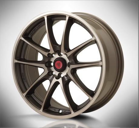

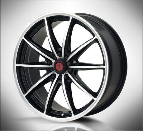

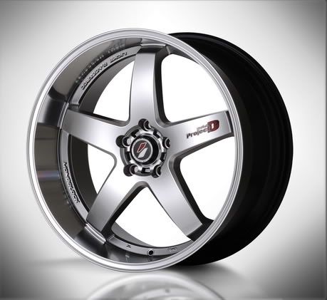

    Thanks Meikey. Your inputs are gold bro! Really appreciate it. I decided to stick with 16" rims. All I need now is to find a rim design that I like. Medyo limited pagpipilian sa size 16. :-)
    Ito yong mga personal favorites ko. Ito din yong mga pinagpipilian ko dati. And end up getting Lenso SC5, para naman at least yong dating is medyo conservative at the same time sporty tingnan..
    SC05
    SC01
    PD1
    And if medyo malalim yong budget, w/c ayaw na ni mrs., ito sana:

    gusto ko yung pd1. maganda. at least sa pix. ewan ko lang sa personal.

    Yong PD1 sir, talagang maganda yong gun metal finish-polished lip combo... Kaso nong time na yon, walang available na stock yong CFG Cebu for the 16s 4 holes pcd 100, meron sila is for FD 18s/5 Holes.
    But I think sir, based on the pictures, if you lowered it more, ipapatiklop yong fender liner would do the trick... Ehehehe, very ingenious solution.... ahahahahahahahaha...

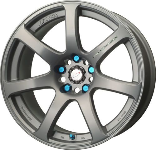

    Maganda din yung pinost mong Work ah. I can imagine it with a black Accent. Also ok din yung TE37 copies. GRID 2. Haha.
