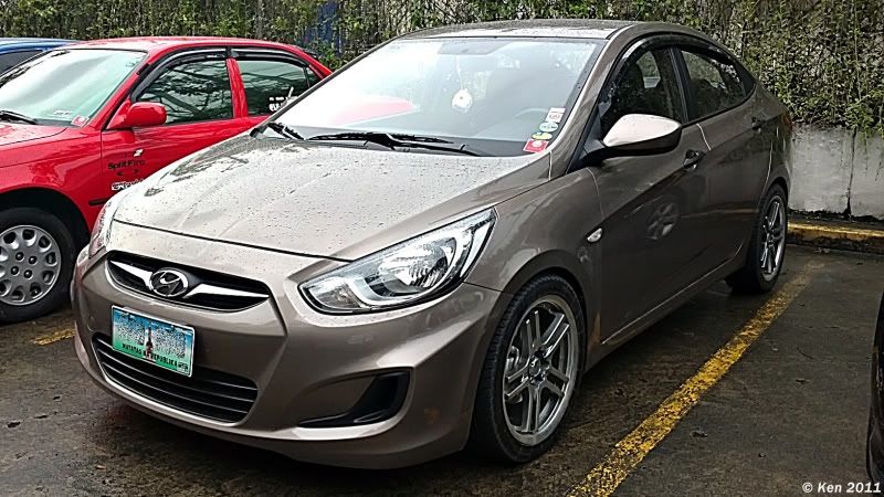

    Share ko lang yung Accent 1.4 GL M/T na nakita ko.
    17s tapos dropped. No tints. Damn nice

    ^ pogi naman niyan!

    oo nga. yong color tone ng mags perfectly blends with the body color.
    it could have been better if medyo pasok ng konti yong spokes ng mags. But its a trade off talaga for a 6J stock tires to a 7 or 7.5" wide na mags. You have to compromise a bit of the offset..
    But it really is a beauty!!!

    Mags palang yan pero ayos na ayos na...pero from the mags meikey baka may tama yan sa fender ano from your post...17s tapos lowered.
