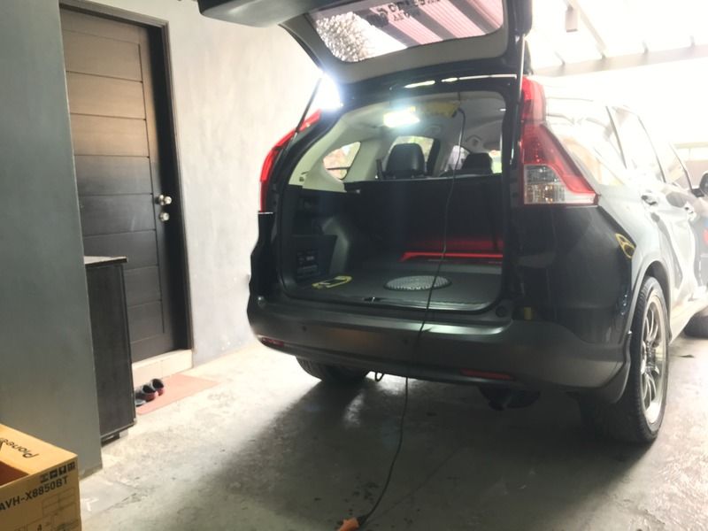

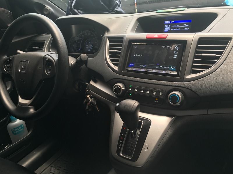

Idol, balita ko magpapalit ka ng HU ah? Congrats in advance hehe. Kakapalit ko din ng HU after 1 million years. Malaki nga difference if Highlevel input vs RCA out. Bypassing the internal amp of the HU, made the background black-er. Plus mas malinis yung LF ngayon. Sulit ang upgrade! Here are some pics para pangkulam.
Palit wiring from HU to Processor kasi RCA out na.
Finished product.
