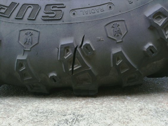

    thanks bro, sample pics lang yan, same ng nangyari sa tire ko.
    looks very bad imo. baka hindi din tatagal tyre mo kung sakali ni repair.

    repost ko lang pix ni d'flash:
    Looks like the tire was under-inflated and used a lot that way to cause that crack.
    Diba pag underinflate eh dapat horizontally yun mga cracks

    Quote Originally Posted by d'flash View Post
    sa sidewall sir eh, so di ko muna pwede ibyahe ng malayo? or pag pinatapalan ko po ba? will it work?
    sidewall? delikado.... bubukol din yan, tapos pwede sumabog.
    wala naman nakitang thread at nung chineck ng tire shop susunugan lang daw, para magdikit ulit, sir mda dapat ko bang bawasan na lang yung psi ko? from 30 to 28?
    I'd rather not lower the psi kasi underinflation (aside from higher fuel consumption) generates excess heat = may also lead to blowout.
    Again, since we haven't seen the tire itself, it's important to note that whether or not the tire is safe to use will depend on the depth of the cut compared to the actual width of the sidewall. I'm just saying that if the cut isn't so deep (lack of pics, difficult to call), you can still *probably* use it.
    I'm hoping the tire is due for replacement anyway sometime soon.

    #50
    ayaw niya maupload pinatapalan ko na kagabi, at "sinunog" daw para kumapit yung tinpal, pero pag tingin ko knina umaga, bumuka ulit yung tapal niya. pero ni tire guy sa labas lang daw yun,
