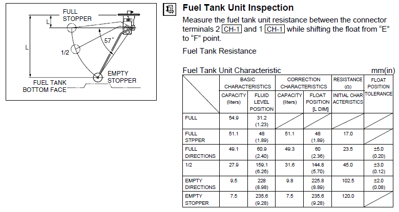

    From my knowledge 5-7 liters. I posted somewhere here as taken from the factory repair manual.
    Confirmed, 7.5 liters: (see diagram below)

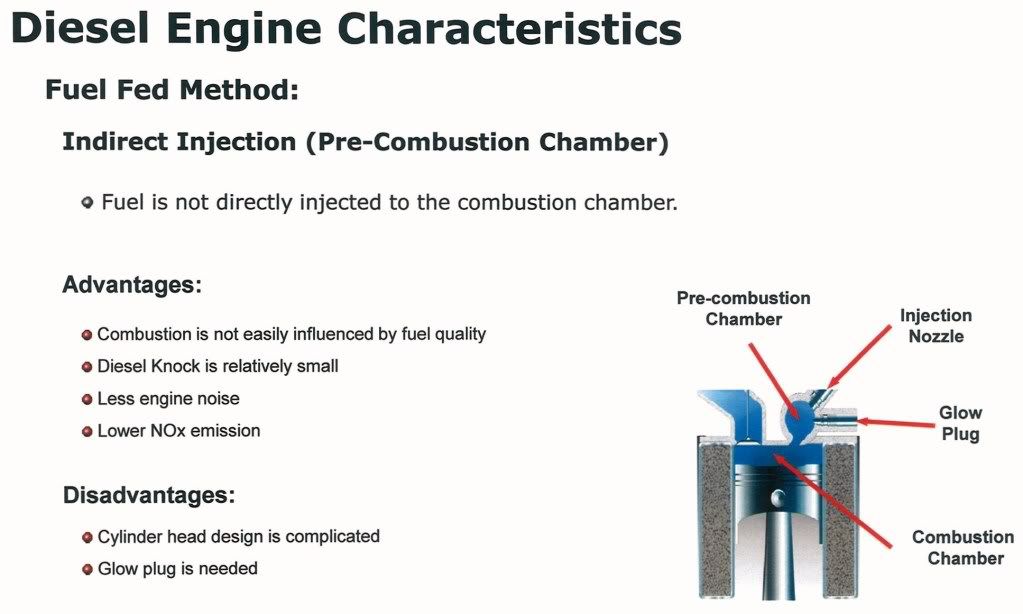

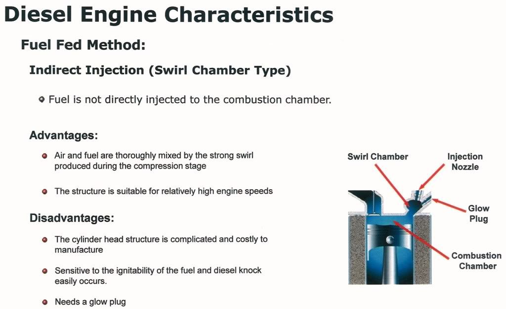

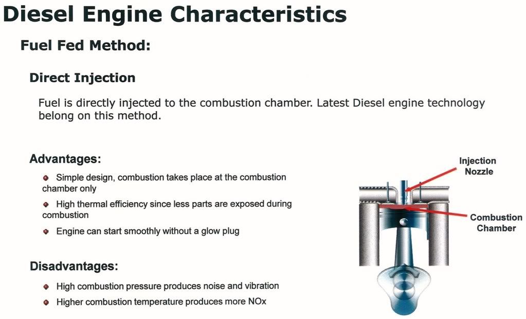

    sir i have one question, what is the diff between direct injection & indirect injection engine?crosswinds have a direct injection engine but they say its old school engine compared to the crdi engines that other most brands are now using.

    This would best illustrate (and answer) your query:
    INDIRECT INJECTION
    PRE-COMBUSTION CHAMBER:
    SWIRL-TYPE CHAMBER
    DIRECT INJECTION
    Hope this helps!

    Just like to inquire between the direct and indirect injection discussion, does this mean that the crosswind is a fuel-injected engine? I am asking because I am planning to buy a fuel-injection cleaner that will be added to a full tank of gas and is supposed and advertised/claimed by the cleaner to clean the injection system. Hope folks you can assist. Thank you.

    Yes, all ISUZU vehicles are already Direct Injection. A little trivia, ISUZU was the first auto brand to introduce the Direct Injection technology in compact engines.
