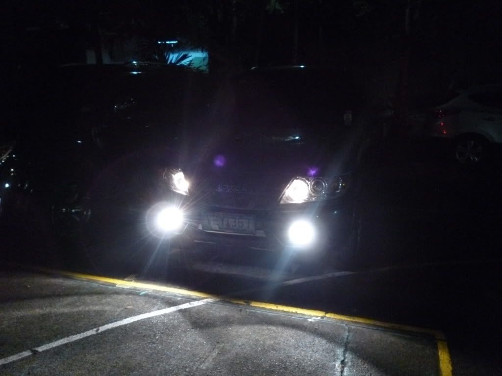

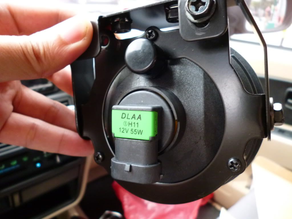

    DLAA Fogs from Hotrod, installed by Jemson:
    http://docotep.multiply.com/
