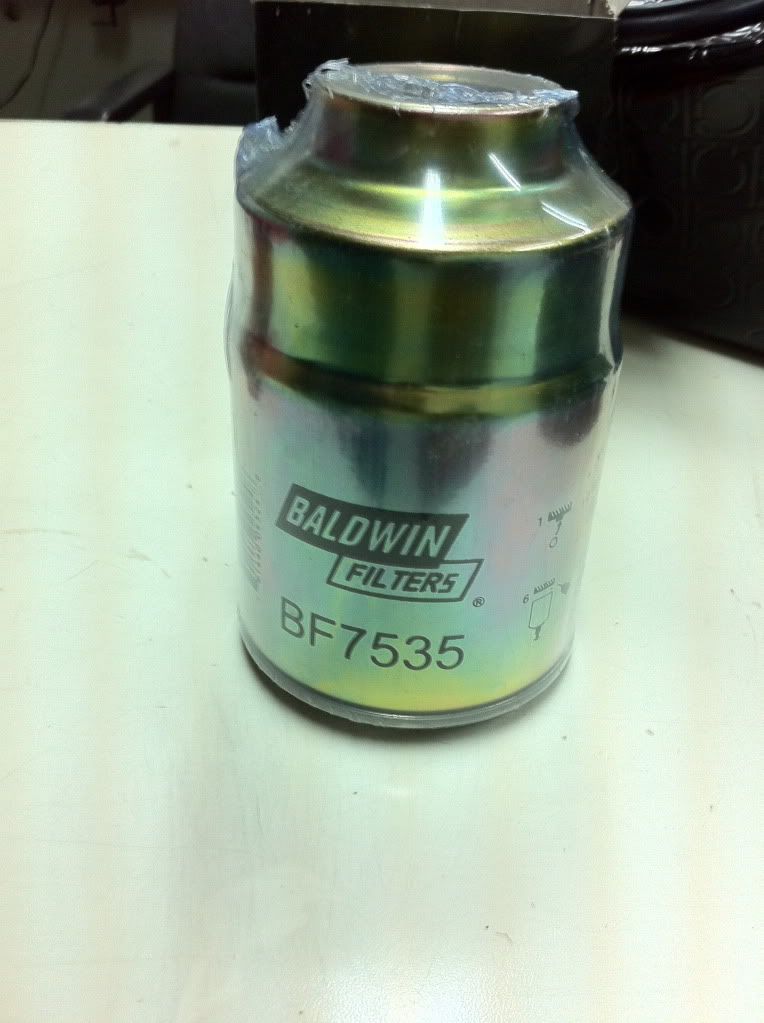

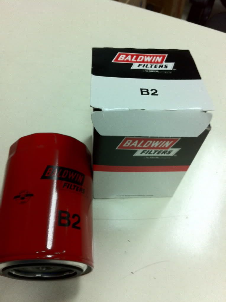

    Hi All!
    I got these from Volmax just a while ago:
    The B2 oil filter:
    The BF7535 fuel filter:
    Are they legit?
    Will be changing our the oil filter every 10K and the fuel filter every 30K as per dvldoc's recommendation. Will be using Shell Rimula X Black 15W-40.

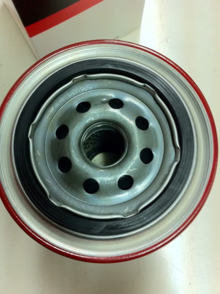

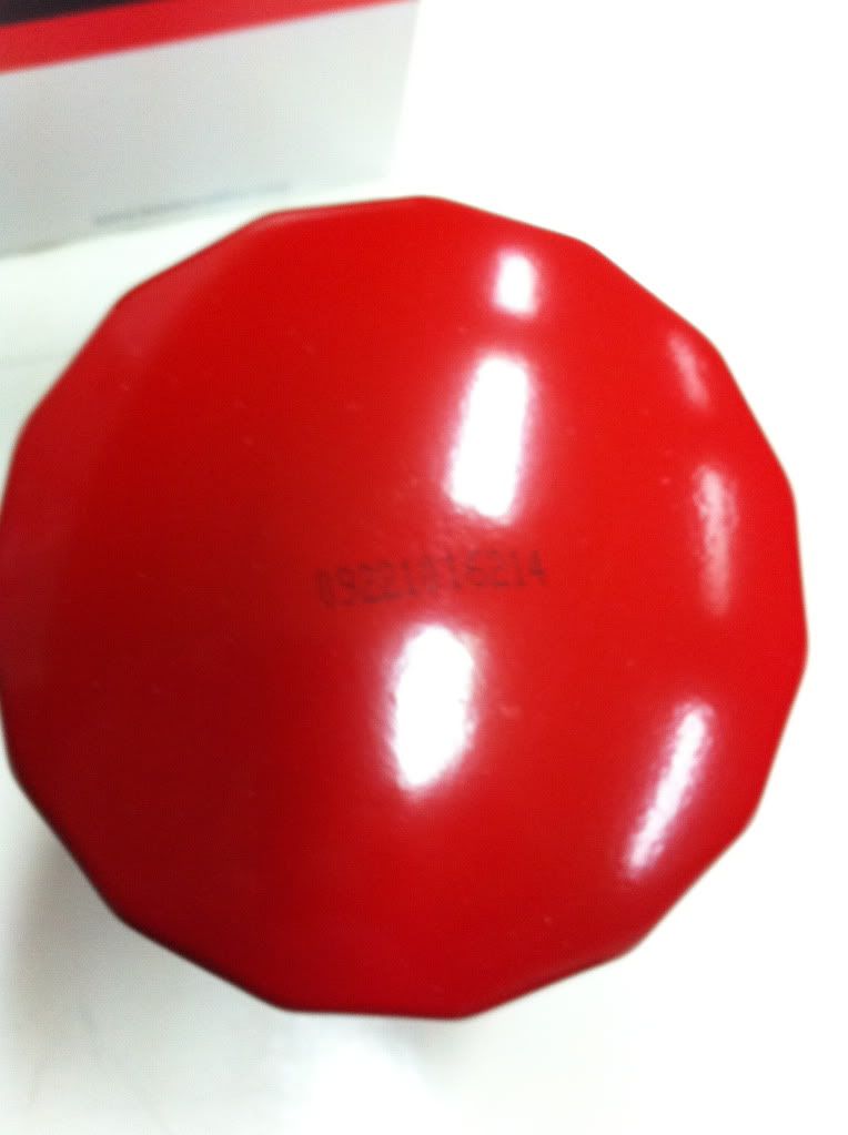

    May country of origin ba sir sa oil filter? How much sir?
    Looks legit though.
    Yes, it does. It says "Made in USA" It's the round printed thing with "wings" at the left.
    ^^ As per my experience with Volmax, all Baldwins are legit..
    B2 has the synthetic version B2-HPG, have you asked if they got one already? last time i asked wala pa daw.

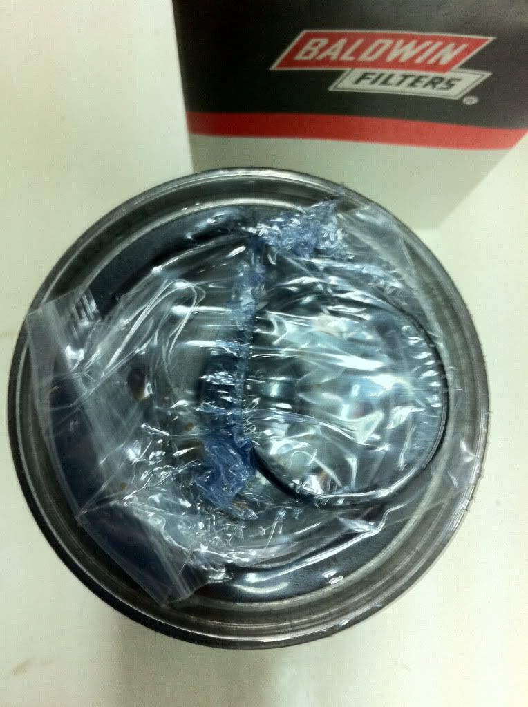

    Be warned thou BF7535 has an inside out flow direction thats why the screen of the element is on the outer-side.
    (dont bother looking at the fake FG on the right)
    Inside out flow? Does this mean I have to switch the feed and return lines at the filter? :uh-oh:
