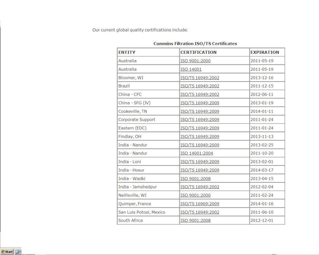

    The second thing is all production plants have a certificate of certification. These are the only approved Fleetguard manufacturing sites. Notice there is no TURKEY listed. As I stated before there is no plant there and any filters coming with a made in Turkey stamp do not meet Fleetguard standards.
    This all comes full circle now you see why there is always a country of Origin because only these plants are certified and can be verified and can be warrantied by Fleetguard because they meet the manufacturing standards.
    Here is the interactive link which I posted before.
    Quality Policy and Certifications
    As you can see here there is only 2 plants in China both are in Shanghai and both are certified they follow the same date codes, the same filter packing standards, the same country of origin as all the other makers.
    http://www.cumminsfiltration.com/pdf...y/china_jv.pdf
    http://www.cumminsfiltration.com/pdf.../china_cfc.pdf
    These are just the facts.

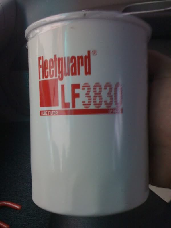

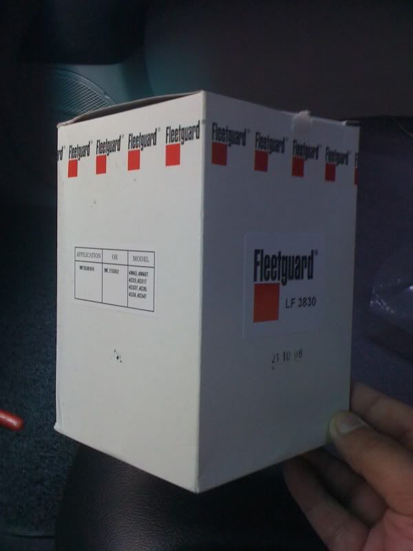

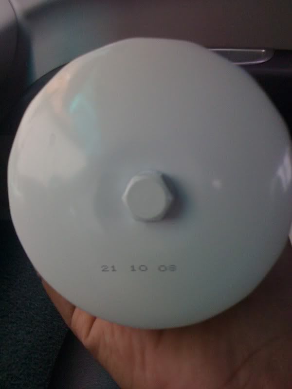

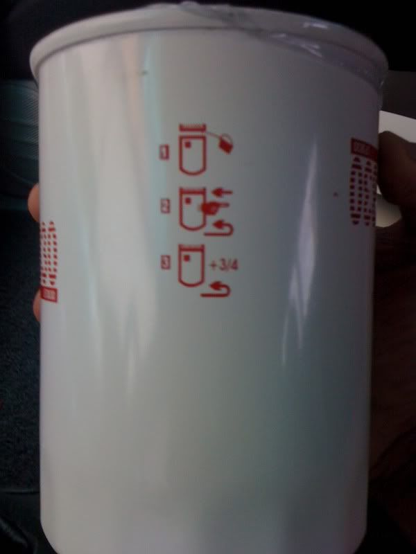

    But if you see a filter like this PASS ON IT! This is from the other listed Fleetguard official vendor. Which makes me think Singapor is the main problem in regards to this.
    Individualy boxed with no country of origin, no item description ie. Lube filter no part number printed on the box.
    No Julian date code which is standard for Fleetguard
    Not fully sealed in plastic
    No country of origin
