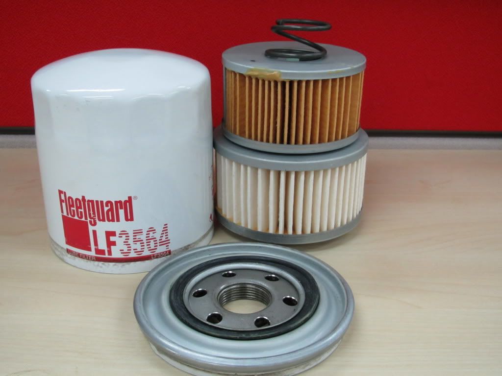

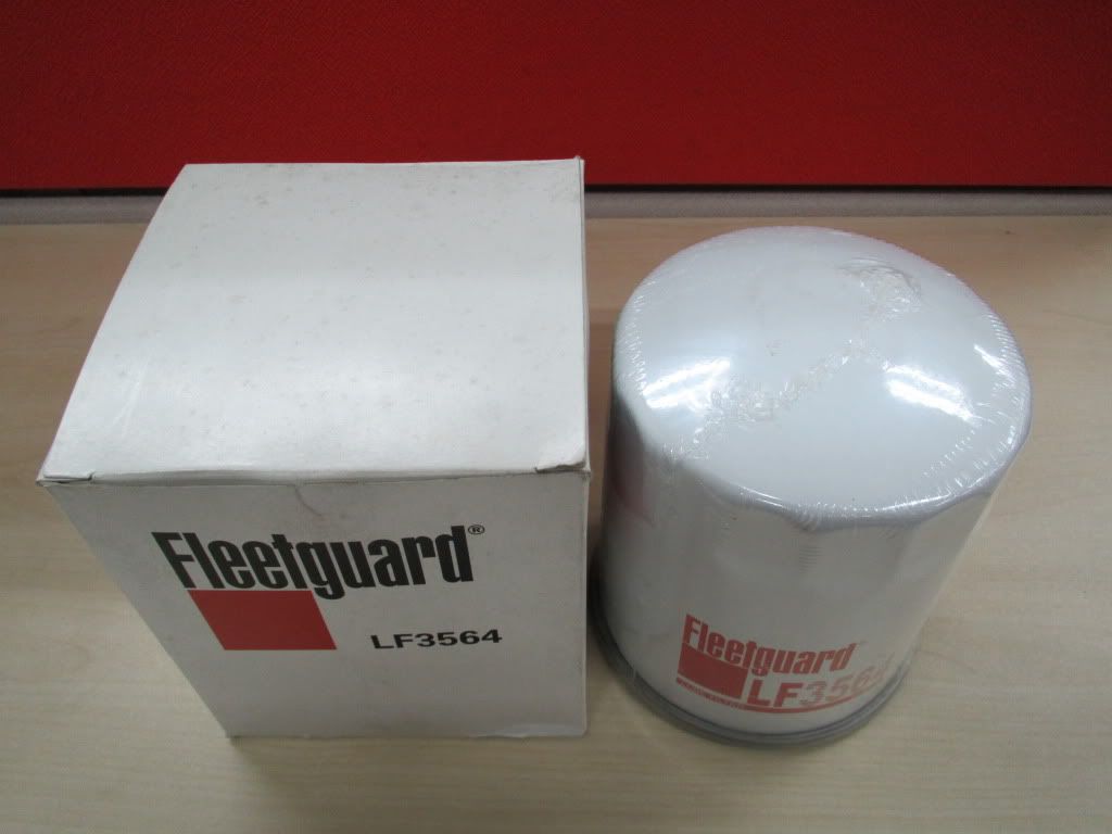

    Well here's what Fleetguard sent me.
    Anyone who has a questionable filter they would like to be contacted, Pics and a invoice of purchase helps out a lot.
    These are the photos they sent of the filter.
    doc, those pictures sent to you by Fleetguard of the LF3564 does not appear similar to the 3D model they show in their website. http://catalog.cumminsfiltration.com...&PartType=Lube, Combination&partflag=0&currentPage=1
    -10 holes vs 6 holes.
    -Different design below Fleetguard logo esp." LUBE FILTER LF3564 ". The website 3D shows them as in bolder letters.
    -The website model shows it being MADE IN ARGENTINA.

    doc, those pictures sent to you by Fleetguard of the LF3564 does not appear similar to the 3D model they show in their website. http://catalog.cumminsfiltration.com...&PartType=Lube, Combination&partflag=0¤tPage=1
    Well the Fleetguard emailed me those pictures saying they were made in Malaysia but, Frankly I would not use them, the quality is much lower than a normal Fleetguard. And they still don't have a country of origin on the filter. Now will they work, yeah probably but rather use a Bosch then that one.
    Another thing the bottom half is supposed to be microglass but it looks nothing like Fleetguards standard microglass media.
    12vdc got this at Pacer and cut it open. It's the real deal and made in the US that other one the media is way to thin.
    Microglass is also steel mesh backed and that filter is clearly not.
    This is a close up of Microglass media. The copper thing is a US Penny to give a reference. You can see the so called Malaysian filter does not even come close on the quality.
