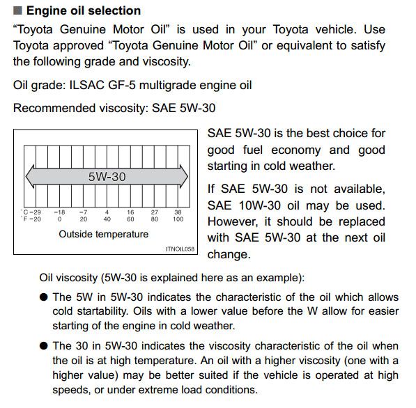

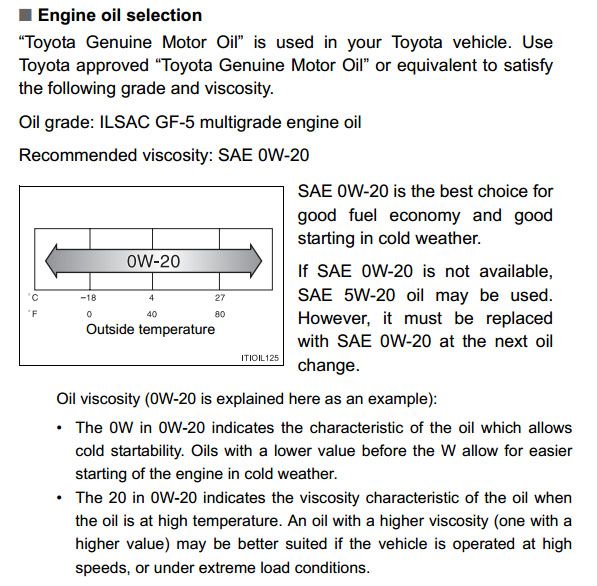

    well to be safe, follow whatever is stated in the owner's manual. example..
    2014 Toyota Camry (USA) calls for 0W-20 or 5W-20
    2014 Toyota Yaris (USA) calls for 5W-30 or 10W-30
    also read the bullet info and apply to your particular case..
    "An oil with a higher viscosity (one with higher value) may be better suited if the vehicle is operated at high speeds, or under extreme load conditions."
    if you fall under above conditions, you can use xW30 instead of xW20 (Camry) and xW40 instead of xW30 (Yaris).

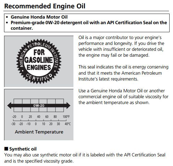

    Quote Originally Posted by jmpet626 View Post
    Yung nasa chart na temp range, ambient temperature yan di ba? Umaabot ba ng 40c dito sa atin? Ma try nga sa Jazz ko yung ow20 oil.
    sige sir balitaan na lang na ninyo kami dito kung ano nanyare...
    Aug 2012
    2,767
    #2354
    hmm, 2013 Honda Fit (USA) calls for 0W-20 even up to 40C ambient temperature. ganito rin ba ang nasa owner's manual ng local Jazz?
    Jul 2011
    1,181
    #2355
    Quote Originally Posted by red_one View Post
    wala dun sa manual ng GE MMC, pero as advised ng planta pwede daw.
