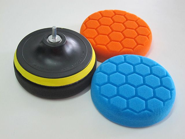

    Dumating na new tools ko.. 5" Hex-Logic Polishing/Buffing Drill Kit.

    Sir ang ganda.

    Black & Decker polisher uses low power motor, has low single speed (orbits per minute), and uses bonnets (cannot use foam pads without modifying the backing plate). You can use them for applying and buffing wax BUT not for paint correction (compounding and polishing) due to low power.
    To compare:
    B&D KP600/KP900 = 60W motor, 1-speed
    B&D KP1200 = 120W motor, 1-speed
    Meguiar's MT300 DA Polisher = 500W motor (High Torque), 6-speed
    Griots Garage 6" DA Polisher = 850W motor, 6-speed
    If wala budget for better brand of DA Polisher, I suggest a drill kit instead. Can use standard velcro foam pads from any brand. Can be used for compounding, removing scratches/watermarks, polishing, waxing, buffing, etc.

    ^ sir saan po ba nakaka order ng drill kit.

    OLX seller name: D3 Technologies. Contact # 09176775587.
