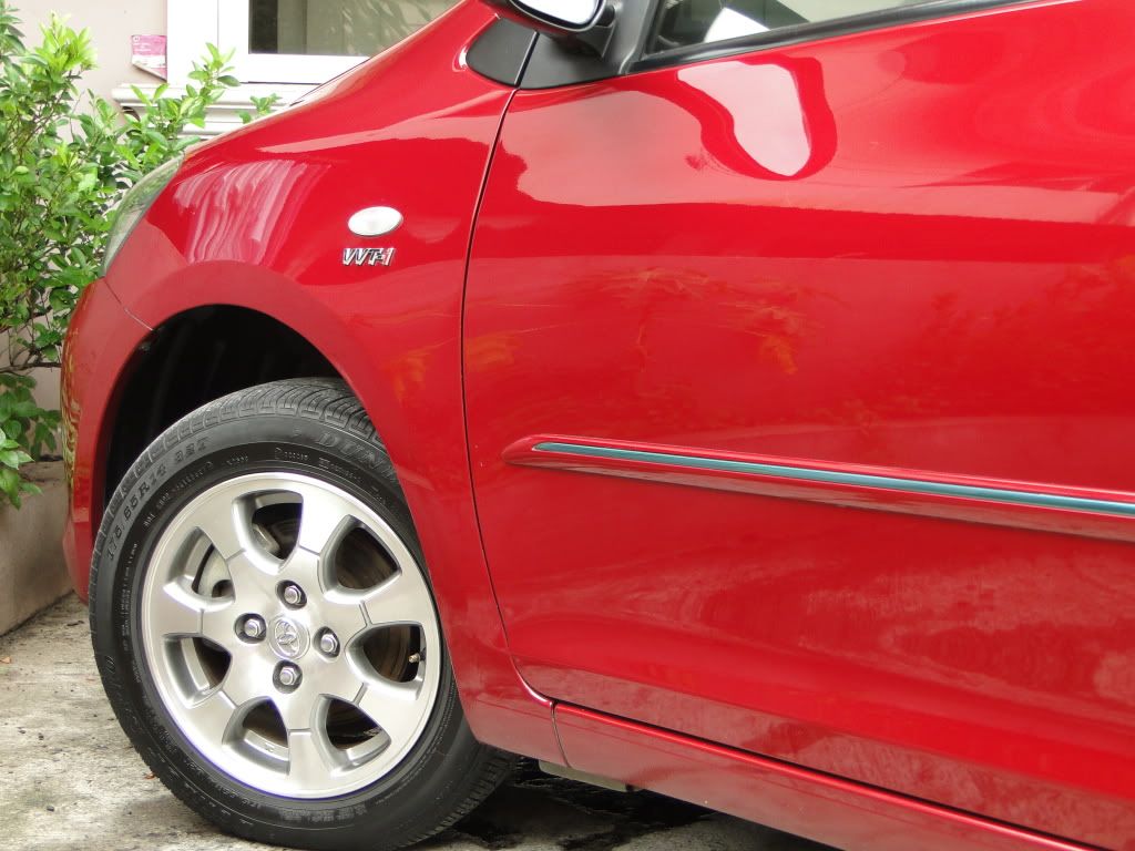

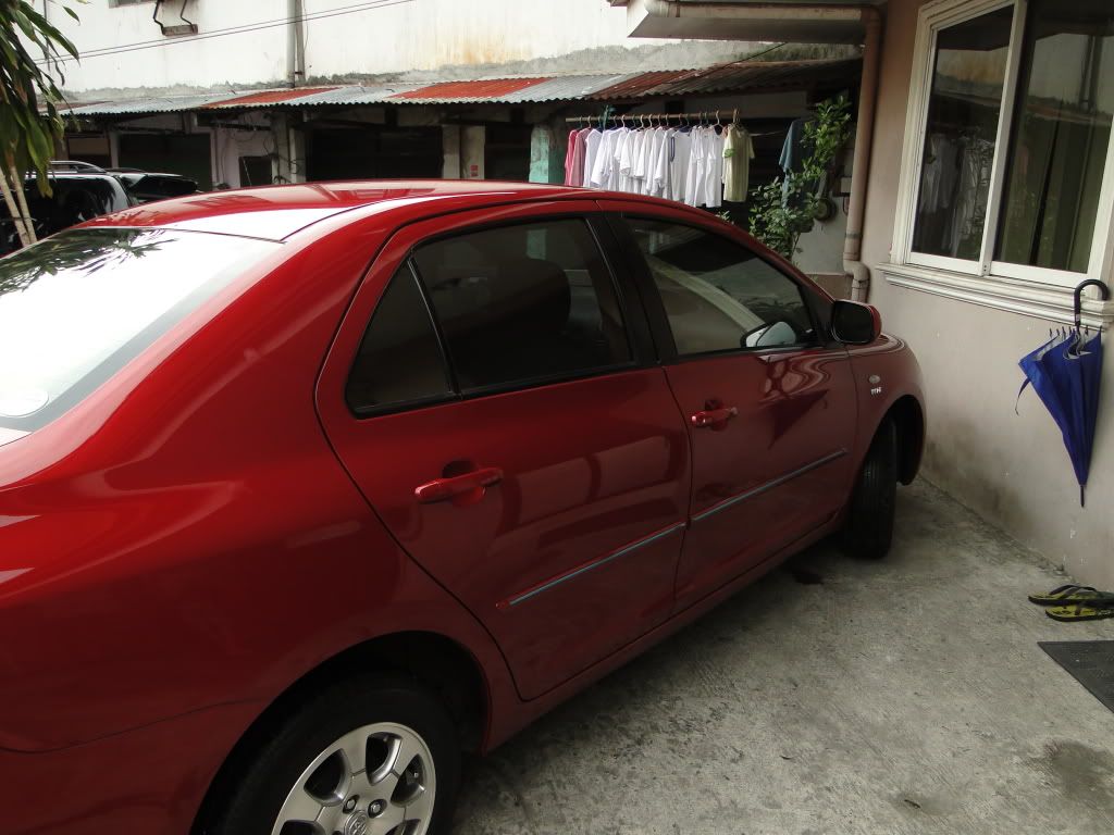

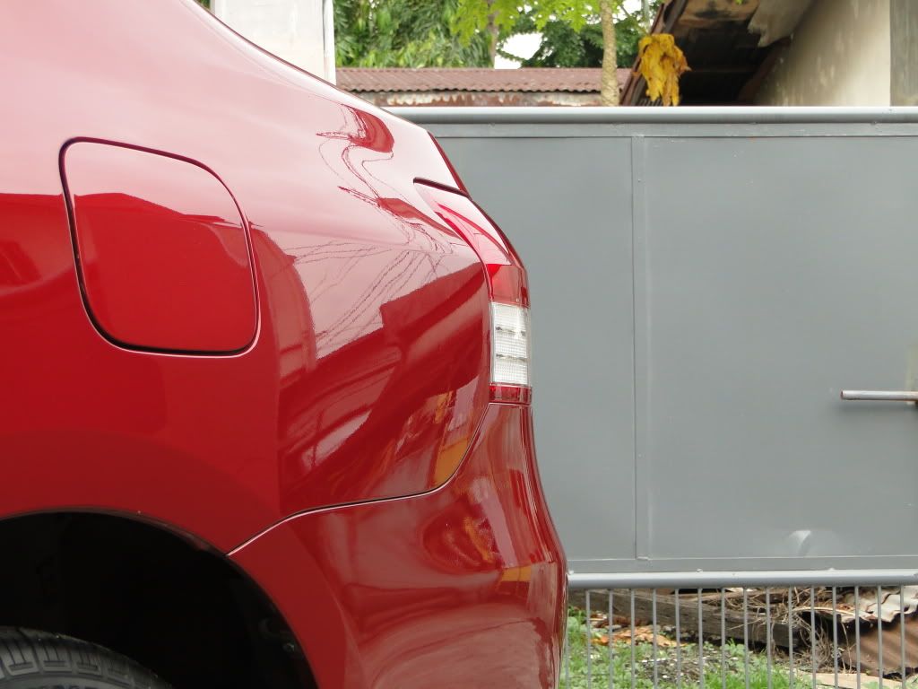

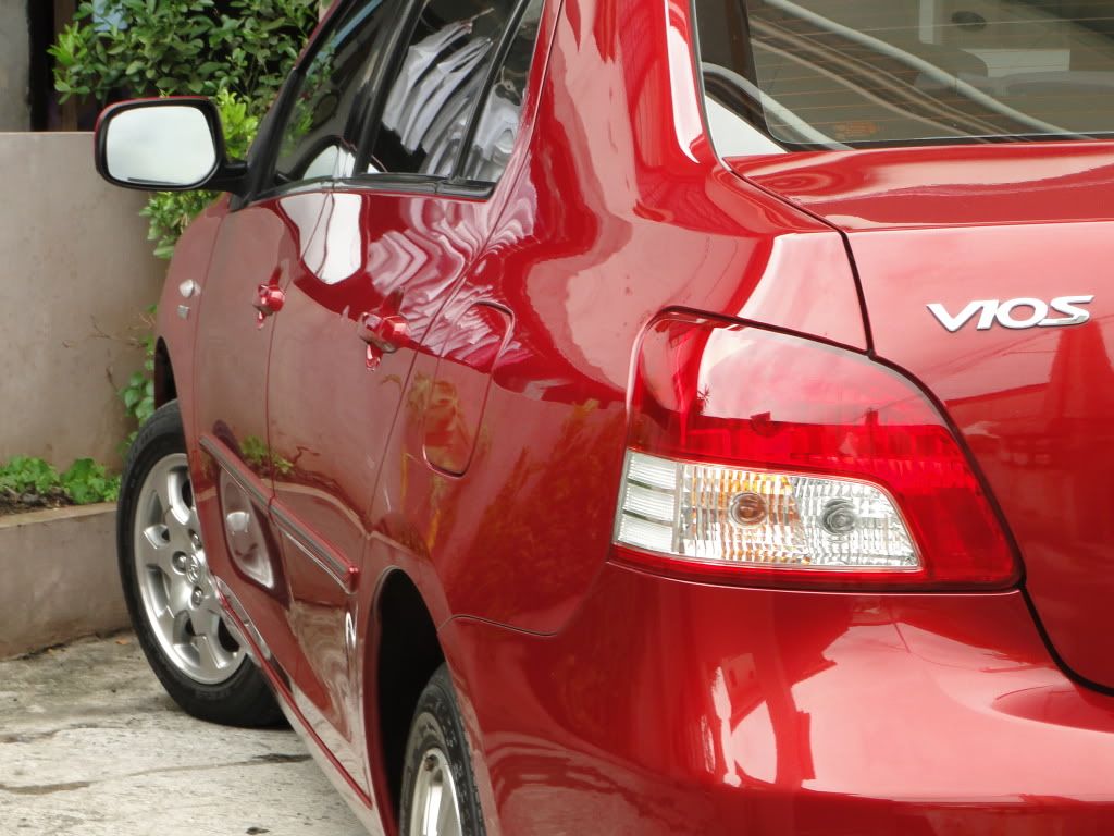

    just finished waxing....
    wash=476/liquid fleet(roof/trunk/hood)....thats all folks....uulan masayang oge
    nice shots! well silvers and colors of the same shade are really harder to show the gloss on camera's but it can still be done but it requires a sealant for it to pop out more
