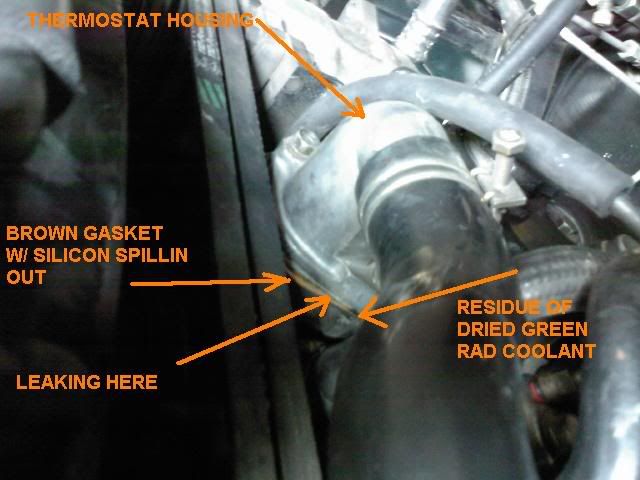

    mga sir, buhayin ko tong thread na to. nagpapalit kse ko ng thermostat kasi napansin ko nakasagad sa baba cold level lagi temp gauge ko kahit kalahating araw na tumatakbo hilander ko. so i bought sa isuzu yung thermostat.ayun after nun umaabot n ako sanormal operating temp mga almost half ng gauge. ganda nadin hatak. kaso ngayon nagbabawas naman ng coolant. napansin ko may leak dun sa part na inalis ..yung housing ng thermostat. problem kasi wala sa casa nung gasket at mejo makapal daw yun sabi nung mekaniko. ginawa nya nilagyan nalang silicon para dagdagkapal yung gapapel na gasket na madaling ihugis daw. i did that twice na tapos tatagal lang ng 2weeks same problem.ano ba dapat gasket tlga gamitin dun???
    help po

    Eto po yung picture nung thermostat housing na connected sa radiator hose.

    Quote Originally Posted by carlogt View Post
    Kung saan mo nakita leak, yon ang uulitin mo.
    That is one reason to use a proper coolant. The dye in the coolant aids in failure
    anaysis.( Residue of dried green coolant)
    Kung tubig lang ginamit mo, makikita mo kaya ang leak?
    Just re do the same procedure, make sure the parts are cleaned well.
    Check the threads of the bolts, I suggest you change the bolts as it may be the cause.
    The bolts should be able to press fit that part, so make sure you do that procedure
    properly. And Find that proper gasket. If you cant find that gasket then talk to a
    machinist for a custom part.

    #99
    Baka bingkong ang mating surface ng thermostat housing.
    Check mo sa straight edge. Pwede mo hasain yan, liha sa flat surface.
    Wag mo overtorque ang tonilyo para di mag bend.
