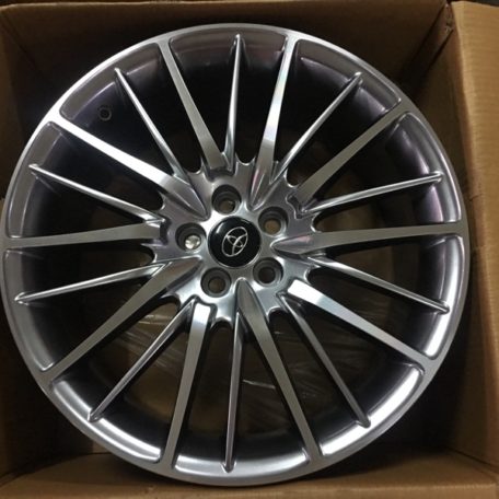

    Can you post a close up pic of your rims and tire? Just like to see the fit (or more of the sidewall form) of the 225 with an 18"x8 rim. As much as possible would like to limit tire width sana. Even the 215/45 baka pwede pa.
    I am considering this Toyota design for Lexus GS350 naman daw, mated to Falken ZIEX tires.
    Could you say the comfort, and underchassis components, are greatly compromised na with the 40 aspect ratio as compared to the stock 205/55/R16?

    Quote Originally Posted by gearhead000 View Post
    Kumho Ecsta LE Sport 225/40R18 on 18x8 rims:
    Overall tire size is kept the same so there is no detrimental effect on the suspension bits. However, because there's less rubber, the suspension absorbs more of the impact. In my experience, it doesn't lead to significantly quicker wear of shocks and bushings. My 2009 Altis with 17" rims had no suspension problems at 94,000 km when I sold it. Same with my 2015 Altis with 18" rims and 53,000 km.

    Mukhang me konting stretch din pala sa 225 x 8. It seems 235 talaga ang "better" match fit wise.
    Kaya lang mukhang ang lapad talaga at 9.3" as compared to the stock 8.1" tire width.
    Thanks again, master jut703.

    Walang stretch bro. 18x8 fits snugly on 225 tires. Another picture:
    Is this for your 10th gen? I think 215/45R17 is a better fit, you can use the TRD rims which have a similar design as the rims you showed:

    Yes, it is.
    Wow, eto ba yun? Any idea where to source and how much?
