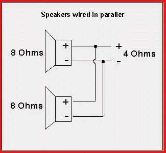

    Ok lang po ba na ilagay yung speaker sa avanza natin yung 150 watts? Without amp.
    Yung 150 watts ay power handling ng speaker. Hindi yan output. Most likely, max power yan at hindi rms. No prolem, you can put that speaker on your Avanza. Hindi mo lang ma maximize ang capability ng speaker.
    yup...'wag lang below 4 ohms ang load, meaning dalawang speaker na 8 ohms na nakaparallel connection.
    Ang stock HU ng avanza ay 4 ohms ang impedance, below than that, mag overload ang power amp ng HU.
    walang problema sa wattage...either below or over....
