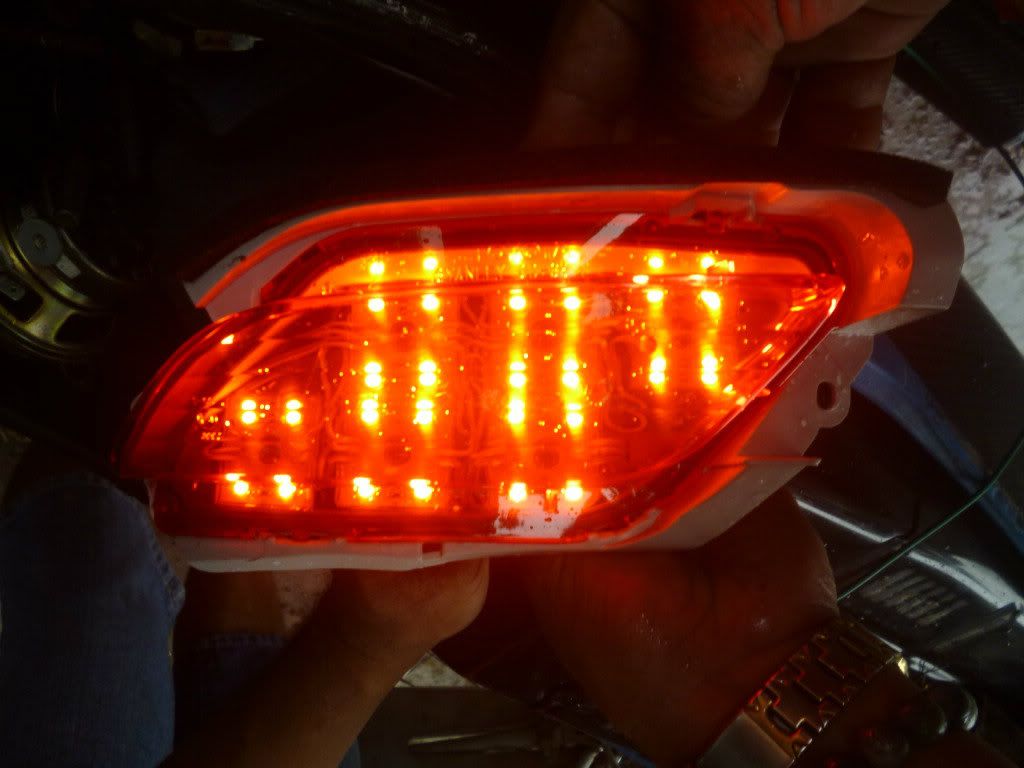

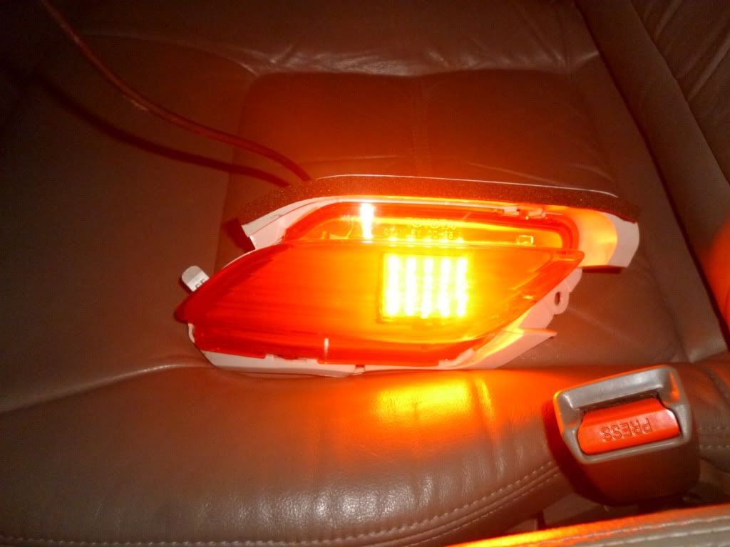

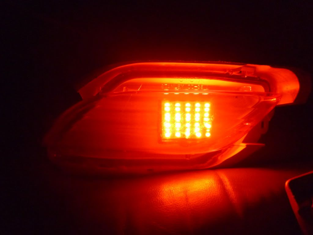

Update: I think it's bright enough. My problem is the lens and the interior of the dummy light are both smooth with no matrix or waffling that acts as a light diffuser. The matrix is the reason why light looks evenly spread on OEM taillights. On clear taillamps, the matrix is on the interior of the housing. Our plan is to use white 3M reflector tape (the one with hexagonal matrix) and stick in on the interior then place the LED sheet on top.
Current progress:
http://docotep.multiply.com/

Doc Pwede pala to hehehe lagyan kaya ng palara ang paligid para may reflector
May 13th, 2012 09:34 AM #24
Yep. Parang ganun po yung 3m reflector tape. Para siyang palara pero may matrix na printed. Sana lang gumana. Paging mikomac. Hehe. Sila madami nung tape na yun.
May 13th, 2012 12:12 PM #25
May ganun palang tape ang 3M. :bwahaha:
Feeling ko Mas liliwanag pa lalo yun. Or lagyan pa ulit ng isang set ng LED para dalawa na sila.
May 13th, 2012 02:39 PM #26
Meron po. Yun ang gamit sa lower half ng aeromed ambulance units in green and white squares. =)

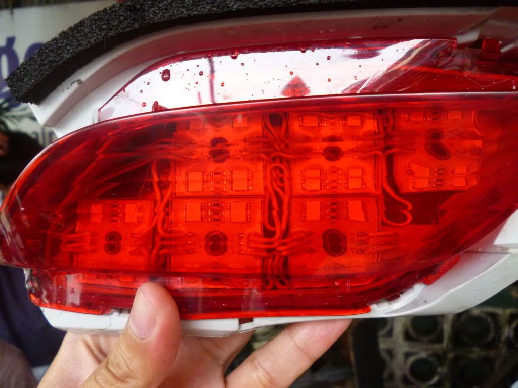

Square LED 'modules' (4LED's per module). We used six modules:
Haven't tried it at night. We will try it on the Vios tomorrow.
