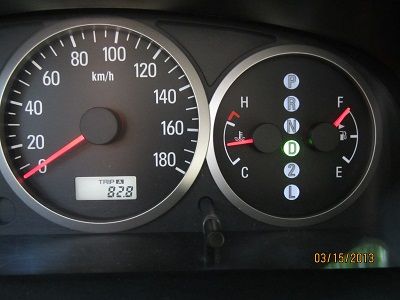

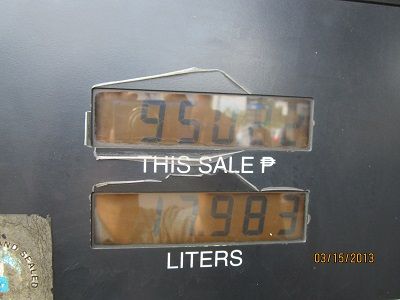

    SIR BOTE2000, ISA PO YAN SA DRAWBACK NG APV ------__------ "MALAKAS SA GAS" once na pinaandar po sya mag sasalita na ang gauge nya "HOLD UP to PA GAS KANA" ako po sir last monday inubos ko hanggang empty tas nag pa gas ako ng 400 pesos Petron Unleaded 400/56.50=7.07liters ang tinakbo lang nya 19.5 kilometers ubos na uli so lumalabas na "2.75kilometers per liter" current mileage ko 7345km...
    Gas up my apv today and it averages 4.6 km per liter city driving in Manila area.
