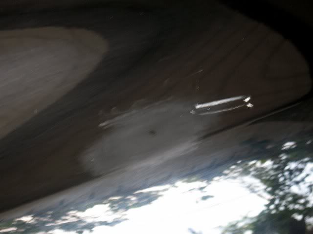

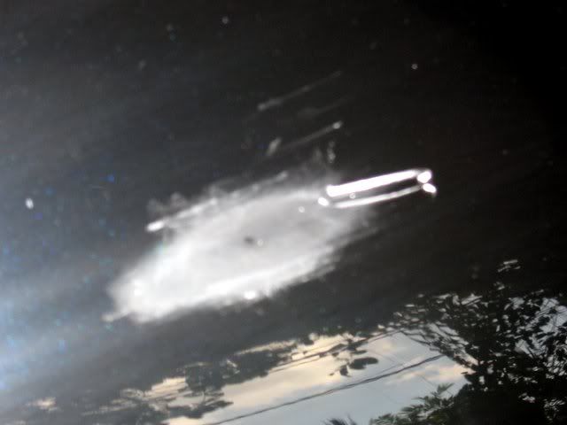

    as I mentioned earlier to ILD, I did some painting, wet-sanding and some polishing earlier this week on my daily ride. while doing that, I took some pictures to record the process...
    here's a pic below of a rock chip on the front-right panel after some spot-painting and wet-sanding (i used 1500 then moved up to 2000 grit)
    ok.. medyo malabo ang pic so here's another na may flash.

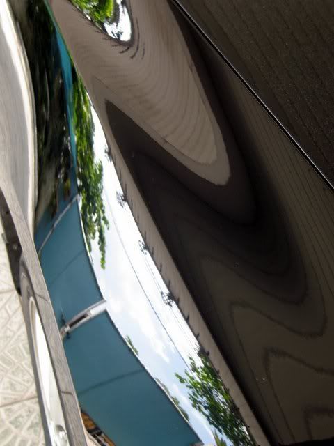

    I then got some 3M Rubbing Compound and coupled it with a Cutting Pad on my trusty Makita and proceeded to buff out the sand marks.
    Here's a pic after:
    another pic :

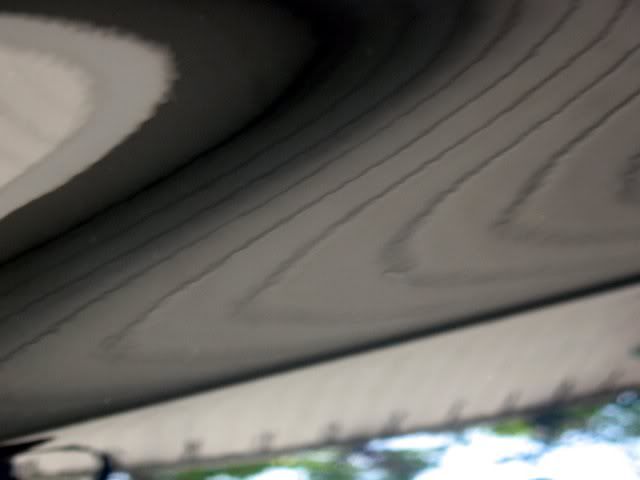

    another pic from a different angle:
    oh I almost forgot to mention: after using the Cutting Pad, I switched to DACP with a Polishing Pad (still with a Rotary) to get those results.

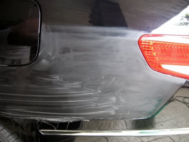

    I also worked on another panel on the rear-left side of my car. (sinabit ko sa drive thru ng mcdo kasi.. hehehe)
    to remove the long scratches, I wet-sanded it with 1000 grit to see whether umabot na sa masilya. luckily, hindi naman umabot. repaint lang needed. so after painting it with 2-3 coats of base, I also gave it some clearcoat.
    here's a pic after painting and wet-sanding.. andaming orange peel nga pala nito. oh, BTW, I gave it around 4 days for the paint to dry before I wet-sanded the panel. nakabilad lang sa araw. ang init kasi this weekend eh.

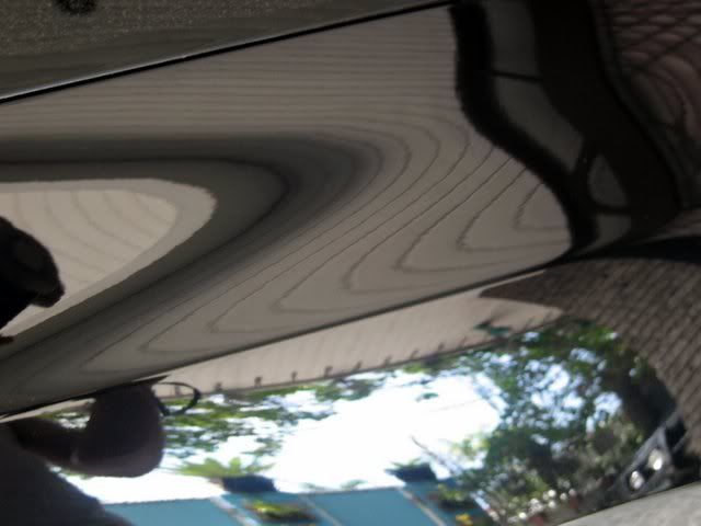

    since naubos na yung 3M rubbing compound ko, I decided to use Megs Compound Power Cleaner instead. i paired this with a cutting pad. then I moved on to DACP with a Polishing Pad.
    here's a pic afterwards: (medyo madilim na.. inabot kasi ako ng maghapon nito. no helpers kasi *sigh*)
    note na may buffing marks yung gas panel. tinamad na kasi ako i-cover yun. had to work on that after..
