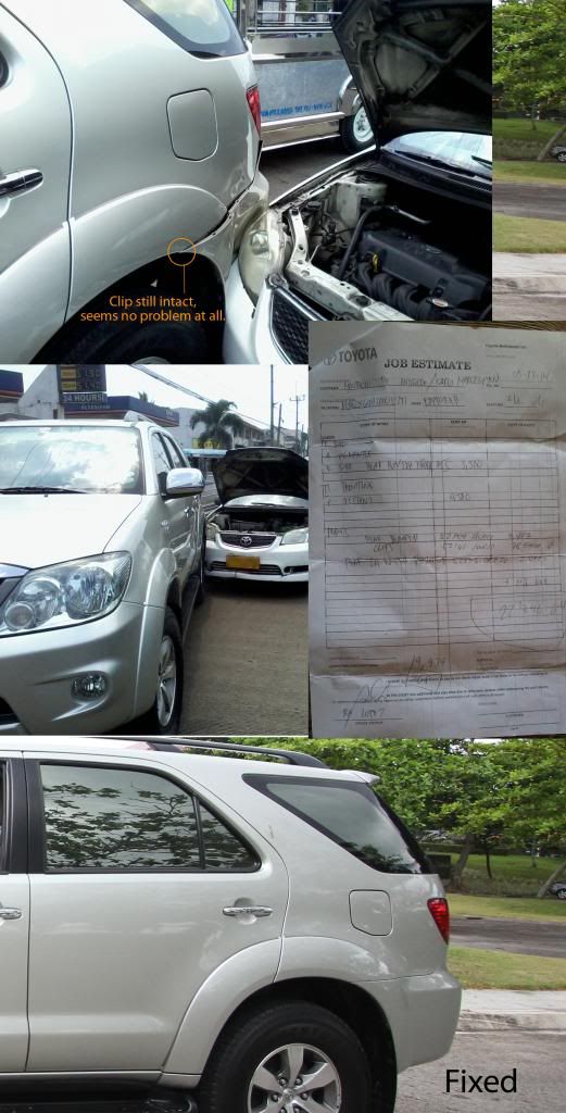

    I'm very disappointed with Toyota Balintawak estimate. Expected sa estimated that price could still go up or down during the actual fix. But When they said na pilas ang hole ng clip and I need to replace my bumper that is something na kailangan i-consider. They said it could be fixed pero walang guaranty since pilas na or broken yung pinagpapasukan ng clip. Costing nila for the remedy is 5k and 22,340 for the first recommendation which is to replace the bumper. After 2 days I went to Toyota Bicutan and have the vehicle checked by the service guy. At first pa lang alam na nya hindi sira ang hole na kumakapit sa clip, he then removed the clip and made some aligning and lastly inserted the clip and presto! gawa na.. No replacement. No repainting needed and for the record walang sira sa bumper ko. Toyota Bicutan charge me NOTHING.. wala naman daw kasing sira. Toyota Balintawak defence is ayaw daw nila masisi later on, baka daw kasi ma fix ngayon and later lumabas ang sira. That explanation is for me valid kung remedy, say sira na talaga paariin lang, but in my case hindi talaga sira. Yung condition ng clip nag make sense lang sa condition ng paint, hindi man lang nag crack ang paint, ibig sabihin hindi talaga malakas ang impact. You may check out the photos below.

    #1627
