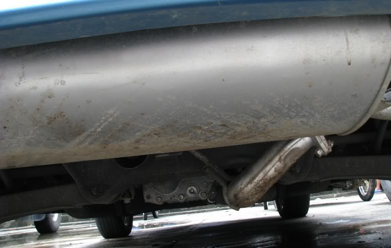

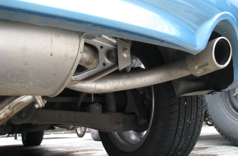

    That is just a muffler "tip". It is usually just meant as a garnish than anything else. If it gets rusty, it might mean you don't run your car long enough to "burn-off" the acids.
    Ito sir yung may rust. Ano pala pwede ilagay para medyo maiwasan? 9 months pa lang.

    Ito na itsura after a year ng pagkakapintura ko.
    Nagsisimula na nman at tag ulan na rin kasi!

    Copper brush mo lang bro tapos bili ka ng high Temperature paint.

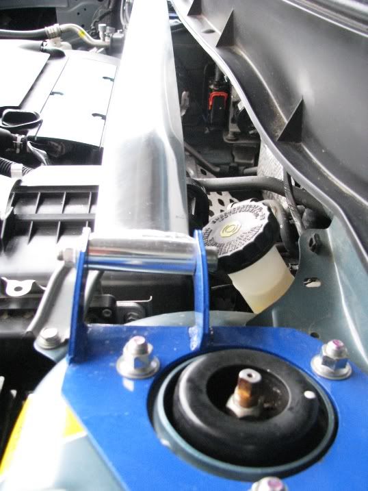

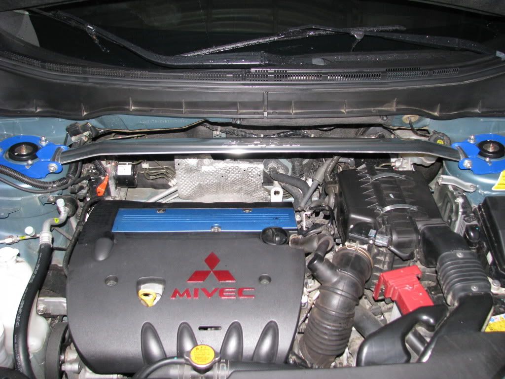

    Very thankful to previous ASX owner who sell me this "strut-bar"!

    Given the suspension towers are already attached to the firewall, I don't think the strutbars would be doing anything beyond aesthetic value.

    How about during cornering GH?

    That is what I meant. You would gain more by upgrading to 18inch wheels and matching tires. (And a upgrade in brake pads too).
