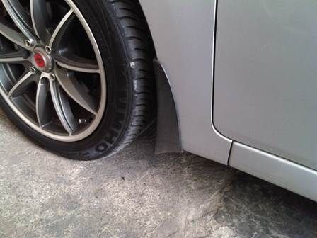

    Guys sino may close-up picture ng OEM mudguard na galing CASA? Paki-post naman please.
    Check ko lang kung bagay or medyo maliit nga gaya ng sabi ng iba...
    Sir renzo, sobrang liit ng OEM Mudguard ng accent. It ain't serving its purpose kasi tingin ko, the body still would be caught up by the mud splash from the tires...
    Kaya ginawa ko, hehehehe, modified an OEM SONATA YF Mudguards, it extended reasonably sa fender, and my door handles never get caught up by muds during hard rainy days...
    Kinatay ko yong OEM Mudguard ng sonata using my dremmel.
    While sa likod, I have to reheat the plastic and mold it to exactly fit to the contours of the rear bumper. Then filled the stock screw holes with plastic fillers (masilya) kasi hindi tugma sa accent. Then use fillers also on the rear mudguards kasi nga I heated them to shape them up according to the contours of the bumpers. Plastic primer, then painted them with matte black...
    Here is the front
    And here is the rear mudguards.
    Hehehe, hindi pa nahugasan ang sasakyan as this was taken early today after a mild rain yesterday...
