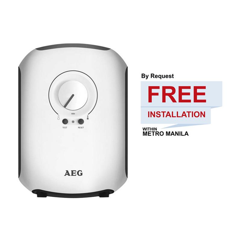

    Ito gamit namin sa bahay. 13 years na pero buo pa din.

    Uy pareho lang nga! Di man lang binago yung kaha haha.
    Mas high end nga naman pakinggan yung Stiebel.
    That's my exact heater model as well hehe.
    12,351
    #174

    Same lang Stiebel Eltron and AEG, they rebranded lang to Stiebel to appear more high end hehe.
    Stiebel Eltron has always been Stiebel Eltron ... They acquired Electrolux which owned the AEG brand ... for some reason, they rebranded Stiebel Eltron to AEG in some markets and then reverted back to Stiebel Eltron ...
