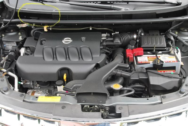

    * lydemer and horsepower - sirs do you mind posting a pic where that access to the vent is and what needs to be removed to access the vent? TIA sirs!

    * shauntot,
    HTH, marked yung spot na bubuksan mo.

    Shauntot, sorry I don't have a GL Sir.

    bobot - thanks for the pic sir!
