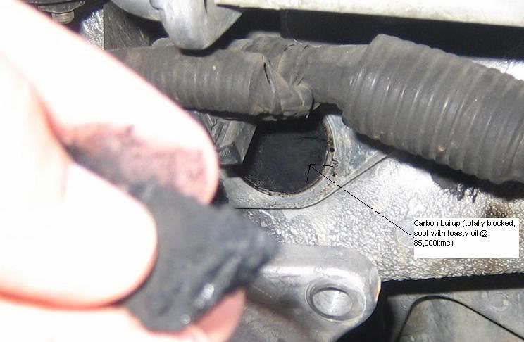

    What your motor looks like without these mods or water injection to keep things clean.
    Complete blockage at 85000K

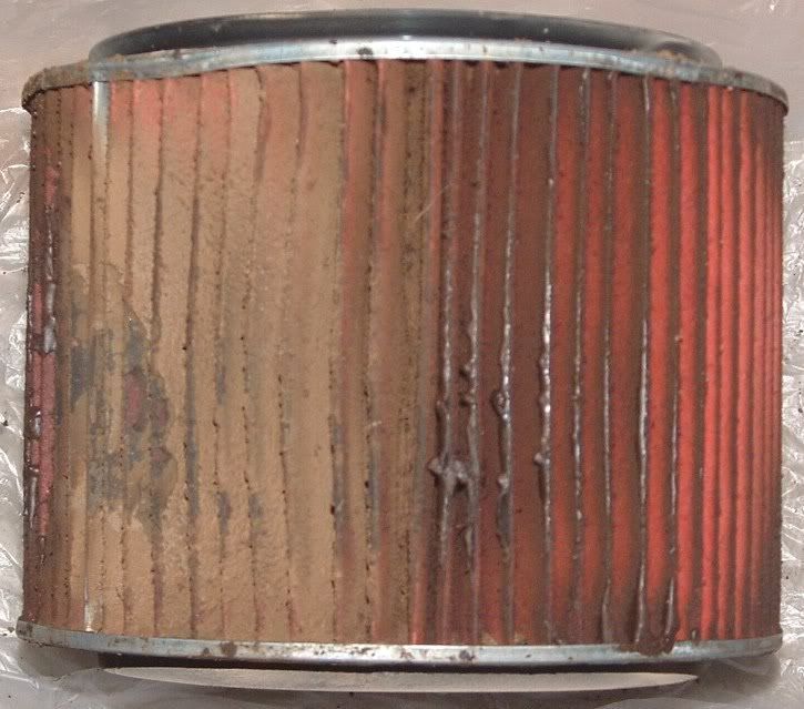

    Air filter fouled by oil mist in just 10000K this will kill your MAF sensor and cause the over boost condition.

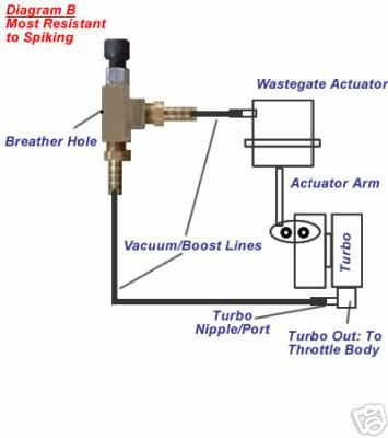

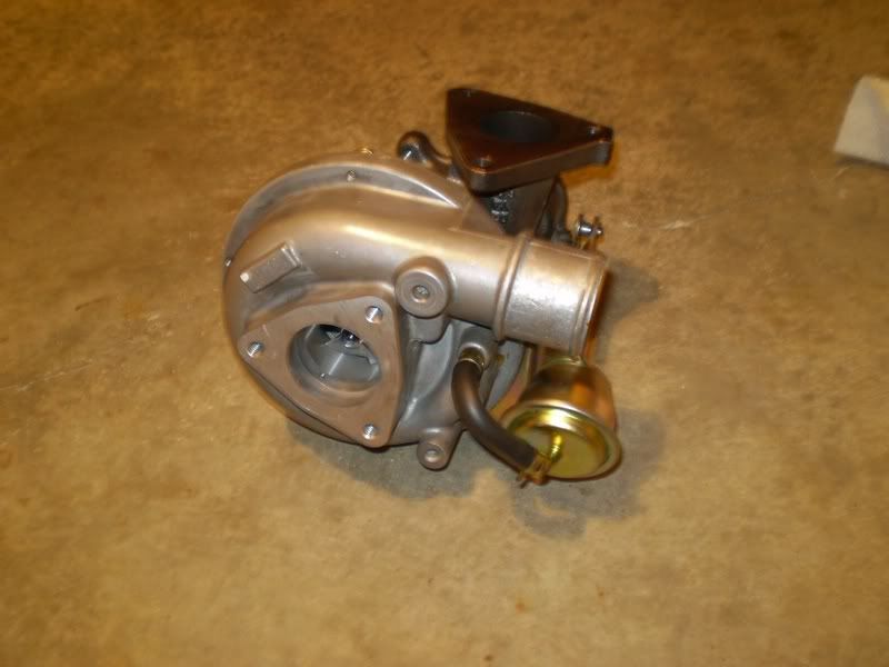

    Here is the ZD30DDI motors turbo. You would put the boost controller were the hose from the turbo to the wastegate is. Just get a longer piece of tubing and insert it.
    This really is a do it yourself job. But you really need a boost gauge to see were your boost is set at stock so you can set it close to that or a few psi above.
