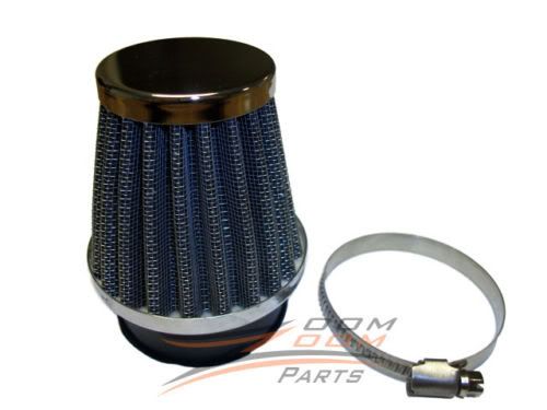

    Here is another little performance secrete for these vehicles. You see the photo of the air intake, That little tube going to the silencer, (thow it in the trash ) Here is what you do, replace it with a motorcycle air filter and you will get way better air flow and really here your turbo.
    If you want even better airflow get a MAF sensor adaptor made up and put on a cone style filter. But I found this little mod does very well and is very noticeable. That silencer really kills airflow.
