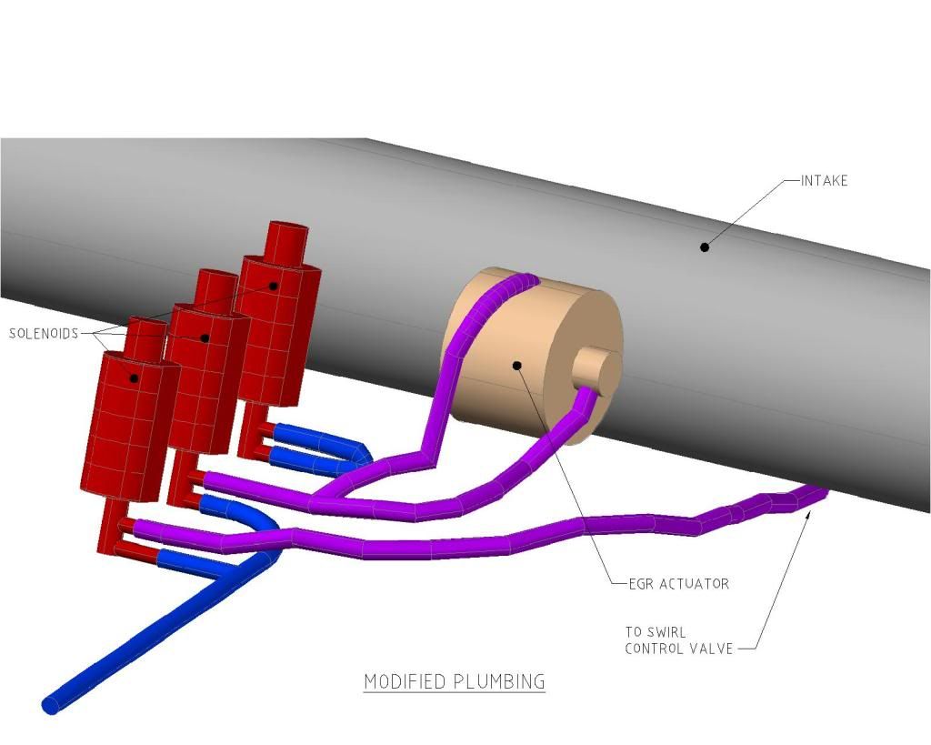

    I removed the entire assembly and placed plates on each end. Had the machinist fabricate MAF adaptor as well.
    http://img441.imageshack.us/img441/4251/dsc0446ne.jpg
    http://img692.imageshack.us/img692/3444/dsc0447hms.jpg
    Dec 2007
    1,961
    You now need disable the swirl valve. I will think I am going to go that route as well and take off the whole assembly versus the hard to reach tube on the drivers side of the engine.
    Stock hose routing
    Disable
    I am going to check if that butterfly valve is held by screws and remove the whole stupid thing.
    Also if you want a nicer looking MAF adaptor hit me up when I am back next week.
    Think I have 1 or 2 left. Mine are stainless steel coated with rust proofing paint then coated with 1500F paint.
