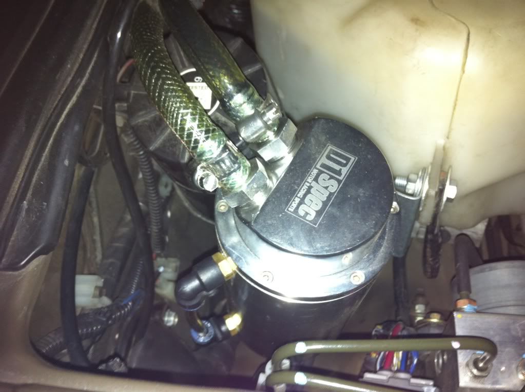

    Just drained my OCC after 5000kms, gulat ako sa nadrain kng langis, can't imagine na magrerecirculate ulit yun sa preturbo air intake nung monty and may konting tubig pa, na PM ko tuloy c dvldoc, normal lng daw since very humid daw pinas.
    bro, anong brand ng OCC na nilagay mo? can't find kase one that has 15mm fitting...

    Thanks! Wala daw na kaso kung mahaba yung hose?

    query: occ is for diesel engine lang po ba? thanks. sori if OT

    interesting. what are the advantages of putting an OCC? might put one if the benefits outweigh the risks

    Regarding dun sa mahaba na hose, I think as long na close system sya ok lng siguro since positive pressure naman yung sa PCV and negative pressure yung sa air intake. Some would suggest na mas mababa yung OCC sa PCV .
    There are gasoline and diesel engine owners na naglalagay ng OCC
    Advantages of using OCC: Cleaner blowby vapors, actually madami debate about this, pero pinagtatalunan nila eh yung cost effectiveness nya, so far wala naman akong nabasa na detrimental sya sa engine unless di mo nadradrain at mapuno. Parang yung cost to benefit returns nya di solve o bilib yng ibang tao although a DIY OCC can be done. Pero sa kin enough na yung nakita kong nacocollect nya dun sa cost nya

    thanks for this. how much did it cost to install an OCC? pinagiisipan ko talaga yang oil ng diesel engines, lalo na kung turbocharged. kelangan talagang alagaan sa oil. thanks uli
