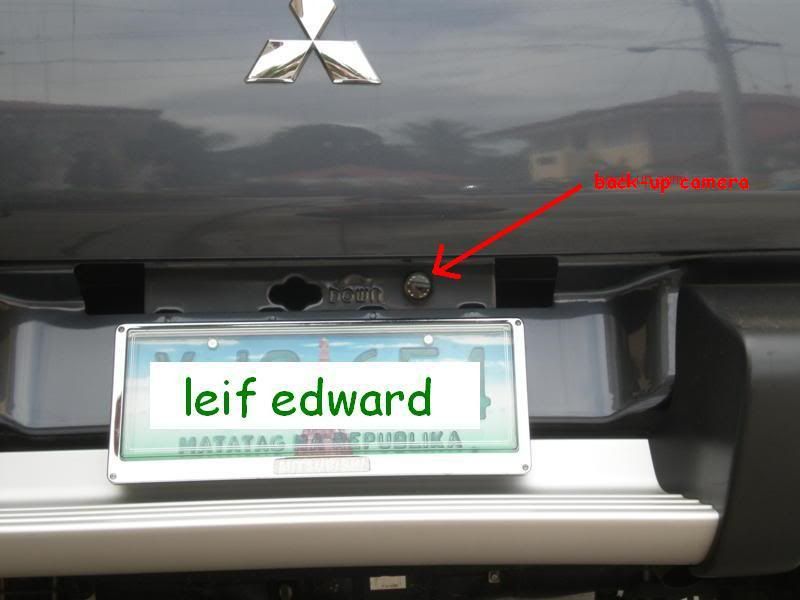

    Bay janrye, here's my back-up cam bolt type binutasan ko yong plate then may lock nut sa likod, connected to my HU: JVC KD-AVX77, signal come from reverse light so automatic switch on ang camera when you engage reverse gear. a poor man's mod. I got it from Amazon web.
    http://www.amazon.com/Vision-HTC35-W...5657519&sr=8-6

    ganda sir. yung HU nyo 2din?

    Nindot sad bai Leif Edward.
    Di ba sya medyo blurry ang images pag mag-reverse sa gabi with the license plate light on?
    Sa akin kase medyo blurry sa lakas ng ilaw ng license plate light. Na-overwhelm ang IR ng camera. Baka i-disconnect ko nalang ang right side license plate light to solve this.

    yung HU nyo 2din?
    * Janrye, Single din lang, ipinalit ko doon sa stock, sayang kasing palitan yong MID ko, previous picture that i post.
    http://tsikot.yehey.com/forums/showthread.php?p=1539469
    * Doy, medyo blurred talaga ang kuha nang cam pag gabi.

    BRO, warning lang. bawal yata na walang ilaw ang plate natin. takaw huli ka dyan. Di ba spyke? so ok lang na isa lang ang tanggalin mo.
