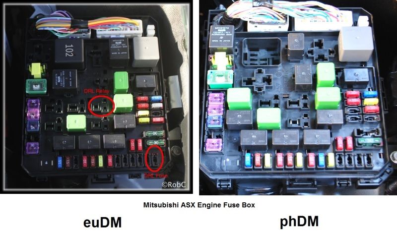

eto next project ko, DRL activation.
i just have to wait for my mom-in-law to arrive from the us this coming sunday - Nagpabili ako ng diagnostic tool + software to tinker our ETACs. On our engine fuse box, me relay at fuse (10a) naka abang dyan. (check nyo yun cover na plastic, nandun yun guide)
eto yun astig na DRL na presyong ginto from a foreign forum, "premium" nga yun term nila kasi if you covert it to pesos, nasa 20k or something (la pa customs, tax nyan)
here's the link btw: Mitsubishi ASX Owners Club - ASX Owners Club :: Topic: Fitting LED DRLs - Guide (1/3)

Yes, it's for a European version but afaik, the electrical system would be the same. Here is another link from the same forum for DRL DIY, for those interested to tinker with their car Mitsubishi ASX Owners Club - ASX Owners Club :: Topic: Fitting LED DRLs - Guide (1/3)
November 2nd, 2012 12:19 PM #2348
Larry, those links were posted a few pages back
Anyway, sad to say GLS has no terminals na abang sa fuse box, nakabili na ako ng extra relay for the drl and fuse... (napanis excitement ko).
If you notice on this pix
walang contacts yun tinuturo na lalagyan ng drl relay and fuse - nagulat kasi ako bakit maluwag, nun ni check ko - walang female terminal to catch it. :banghead:
And dun naman sa wires sa fogs, me sinasabi dun sa thread na 3 wire sya - which sa atin is 2 lang talaga. So, kelangan ng not-so-oem-drl-installation skills. Hehe

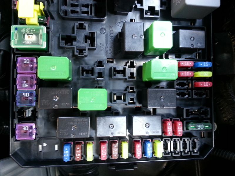

November 2nd, 2012 12:51 PM #2350I have taken a pic of my fuse box...here it is..
it seems what I do not have is an extra relay cause may fuse na ako...I can also see terminals for the relay...does this mean I can activate my DRL by installing a relay?
