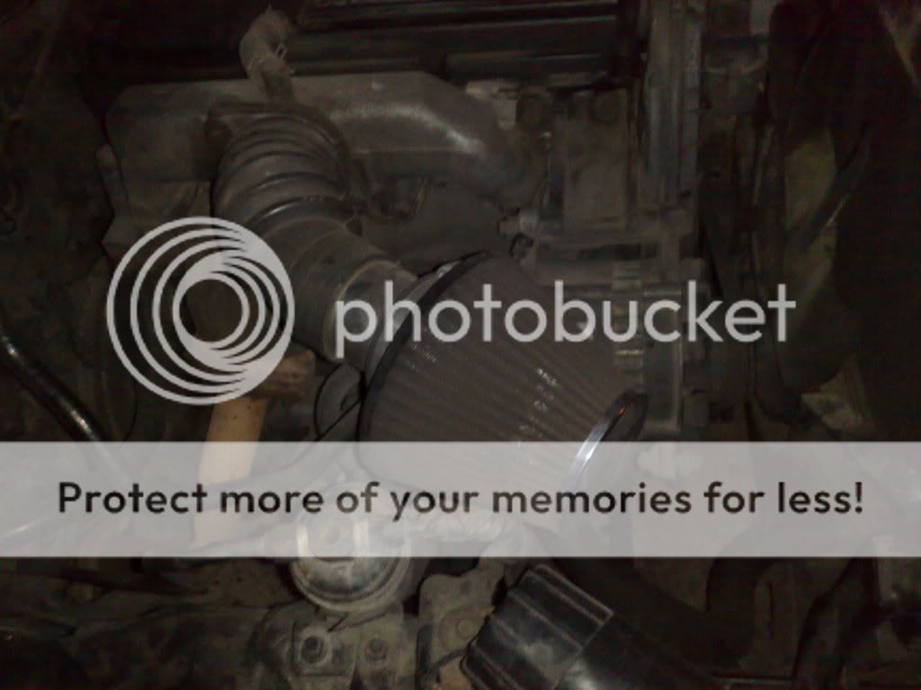

    wala pang engine wash hehehe

    sir sniper5555, engine wash and detailing lang kelangan, ganda na uli nyan! FYI, dapat mas mahaba yun tubo ng air intake mo connecting the aftermarket air filter and the intake manifold. you need at least 6-10 inches more para cold air ang mahihigop ng filter. check mo din airfilter setup ni bborces -- pics nasa thread na 'Mazda B-Series Truckers' Jan 31 2010 EB.'

    Sniper55555 - napansin ko na yung injection pump mo is the in-line type, that's the older model, the newer ones have a distributor-type injection pump.
    Makikilala mo yan from the arrangement of the injector pipes coming out of the pump - sa in-line naka hilera (hence in-line) and sa distributor type the arrangement is polygonal about a common center (parang distributor ng de-gasolina na makina).
    And yes your engine could use a wash, be sure to cover the air filter and any other parts that should not get wet first!
