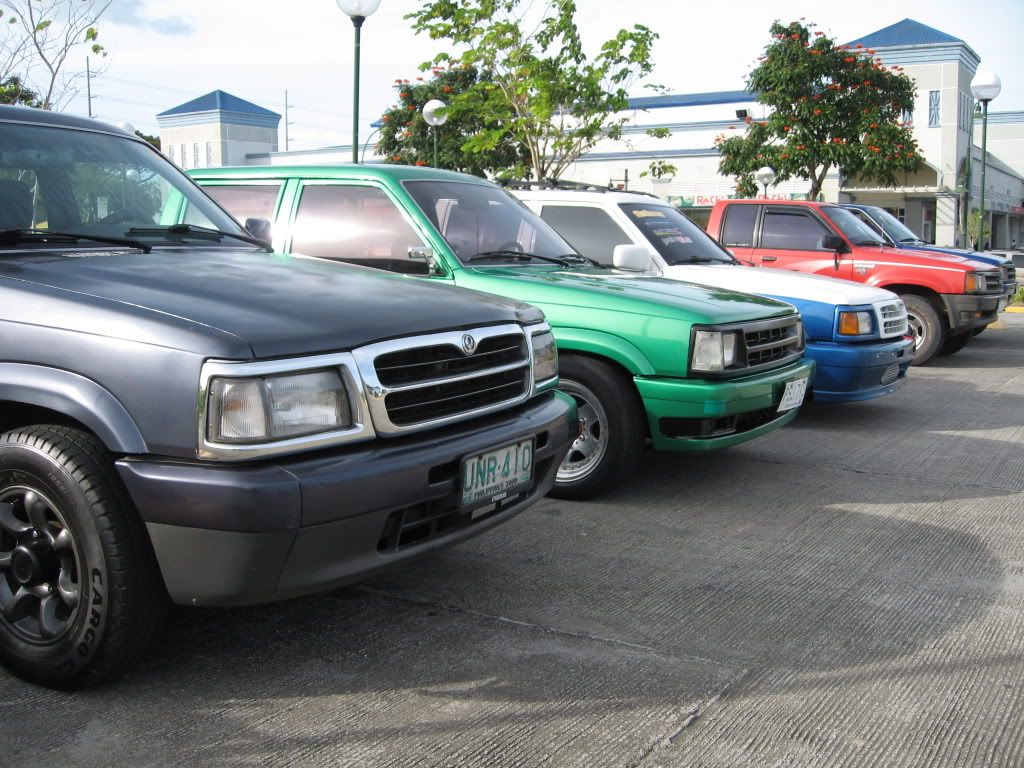

  8. #2048
    7th Mazda B-Series miniEB * Paseo de Sta. Rosa * March 11, 2012
    more...
