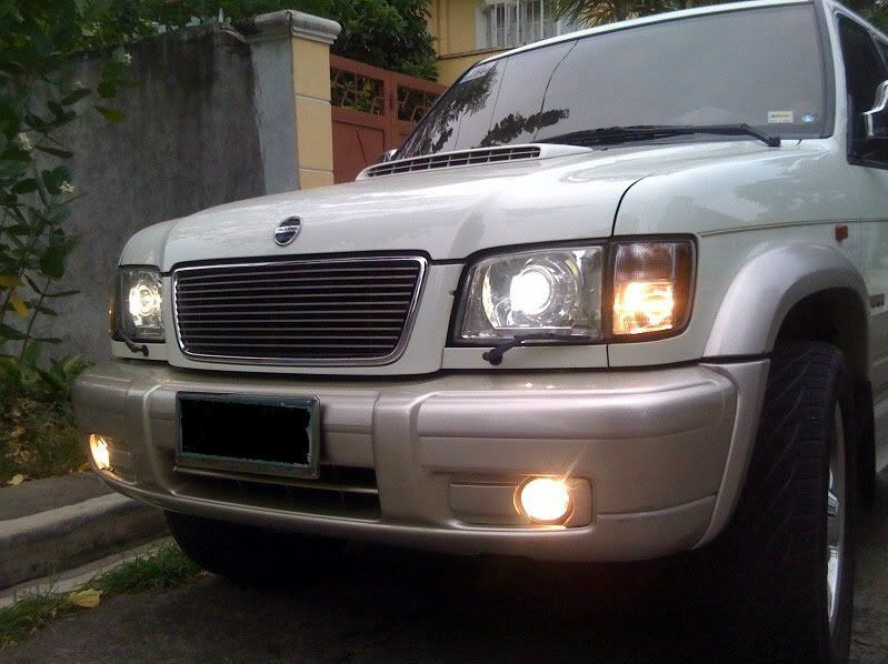

    Mga Sirs, share ko lang yung project namin sa Trooper namin. :D
    • FX-R projectors with 3mm polycarbonate lens
    • DIY foglamp housing and fog lamps
    Thanks!
    35
    #1028
    Looks good! magkano inabot yung fog lamps bro? mukhang good alternative sa plano ko na hella comet 450. Busted kse yung fog lamps ko e.
