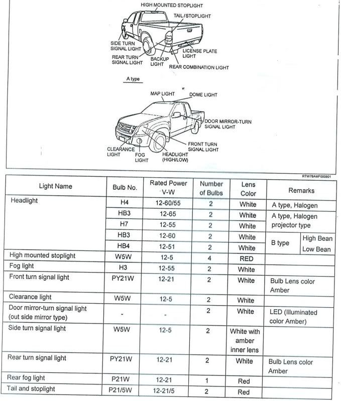

    I am sending a set of xenon headlamp system there in Manila for our 2010 D-Max Limited Edition. My question is what type of bulbs do the projector headlamps use? I do not plan to upgrade the fog lights, but just in case what is the bulb type as well?
    Thanks in advance, and will post pics when this mod is done!

    Hope this helps....

    Same as Crosswind Projector Lamps H7 po ang gamit
