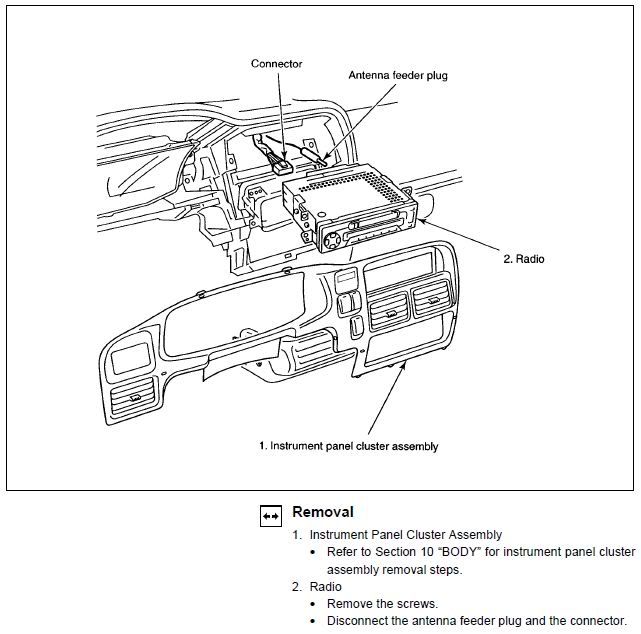

    Quote Originally Posted by Benzmizer View Post
    Simple. Just remove the dash face (not dashboard). For better appreciate, see the illustration I posted below:
    sir benz, tanong po sir-pareho lang ba yan sa older model 04xuvi m/t, balak ko po sana mag diy sa pagpalit kasi ung unit nmin e ayaw na bumasa sa video ung sound ok pa nman. mga magkano kaya sir itong dvd head unit. maraming salamat po sir.

    Quote Originally Posted by taubtaub View Post
    It depends what DVD model it would be. If you're to refer to a '09-'10 DVD headunit of the Sportivo, it should be around 20k.
    sir benz maraming salamat po sa info, at Merry Christmas sir at sa lahat ng tsikot members. ty uli sa inyo
