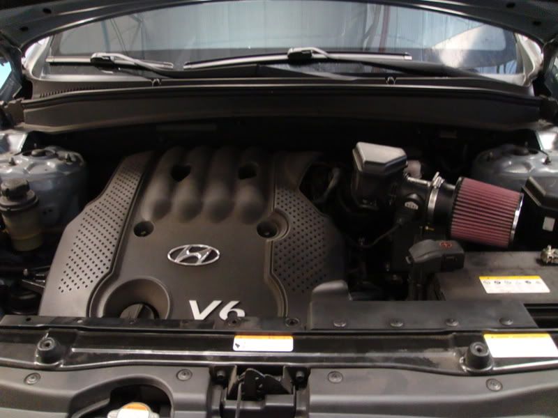

    a bracket needed to be fabricated to support the air filter:
    k&n filter finally installed:

    Quote Originally Posted by DragonHeart View Post
    Finally I was able to install a K&N Filter on my SF... It's not the drop in filter but the open type filter, I have used open type filters for my other cars before and they perform great...
    installation was done by speedlabs...
    Don how much is the total costs of filter and bracket?

    Quote Originally Posted by C190 View Post
    parts # of K&N open type filter?
    K&N filter including installation is Php 5250...
    part # RC-3870
    one thing I like about open type filters is when you step on the gas you hear that wonder growl (air being sucked in)...
    part # RC-3870
    is this "adapter" included in K&N filter or from oem airbox?

    Thats a shor ram intake. I have tried to put that kind of system on my E36 before but eventually took it out and returned it to stock. Indeed, it makes a nice growl when you step on the gas, but what I noticed is that there is a considerable drop in power especially during heavy traffic situations, since that engine bay heats up and the air being sucked by the exposed airfilter is of lesser density than that when it has an airbox. But then again its was just mu experience and is highly debatable and has been going on for years, cold air intake vs short ram intake vs drop-in.
    that's not an adapter that's the rubber end of the filter...

    Quote Originally Posted by TFR View Post
    I have had short ram filters for all my cars, the first was a lancer, then my civic SiR, and now my SF. I have not noticed any power loss (maybe that's just me), but I did notice better reponse and a little more torque...
