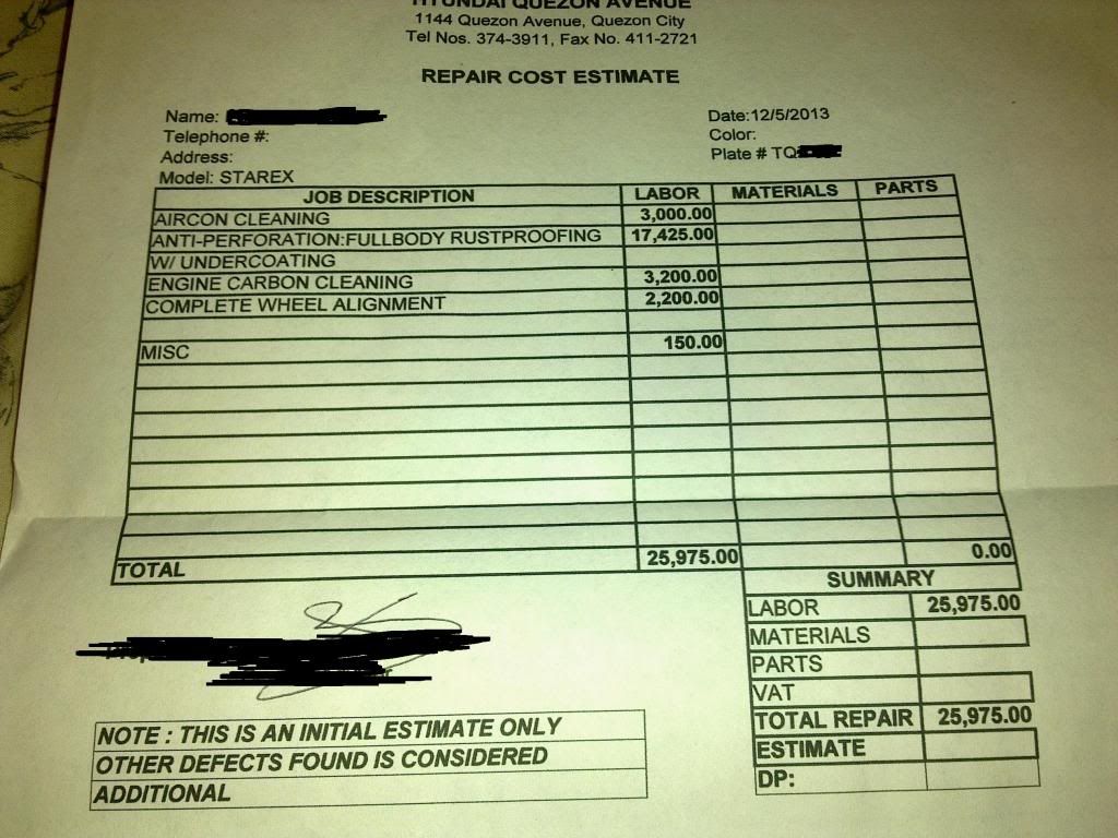

    Are these things necessary? Rust proofing? eh di ba rust proofed na ang mga sasakyan pag labas ng factory?
    Sobra naman yan! 17k for rustproofing??? I'm sure pag labas pinagawa yan less than half lang ang gastos mo

    Quote Originally Posted by ronw123w124 View Post
    Di naman siguro kelangan yan rust proofing na yan.bago pa lumabas ng factory alam ko rust proofed na.
    Engine carbon cleaning - necessary ba talaga to? sa mga sasakyan namin dati wala namang ganyan.
    ugn the rest,mas matipid sa labas. lalo na may pinipirata ako na mekaniko ng hyundai pag day off niya

    On rust proofing: isa lang naman ang dapat at least once a year mo i-inspect, yung nasa ilalim ng rubber gasket sa rear door. Kahit anong starex, from the very first model to our beloved GS, e dun ang laging naguumpisa ang kalawang. Yung sa akin 1 year pa lang kinalawang na. Madali lang naman and solution. Clean the area very well (rust and the gunk from the gasket), treat with rust converter, then paint. Di na need pakintabin/buff yung area since natatakpan ng tailgate.

    mura yung a/c cleaning if 3k lang tlaga. baka nman papalitan lang a/c filter...
