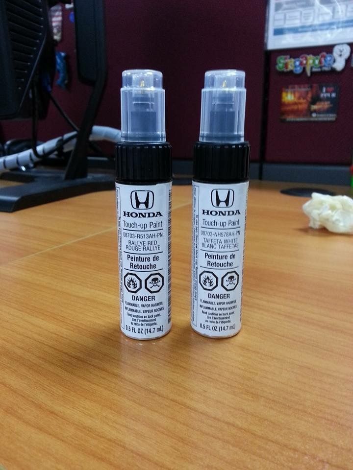

    Quote Originally Posted by makyong View Post
    Sir, ano kulay jazz mo po? Pahiramin kita touch-up paint.
    Sir how much yan? Saan nakakabili nyan. I have crystal black city
