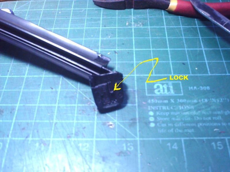

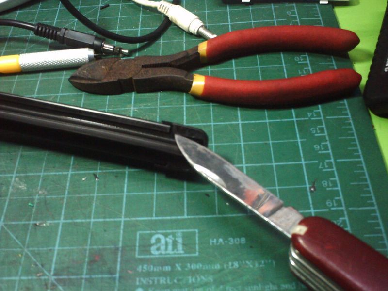

    At the top and bottom, pry off end cap using a dull knife. Pry the sides of the cap, not the ends. the lock prevents movement towards the tip.
    Take note of this lock inside. It must engage when you close it later.

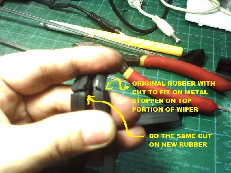

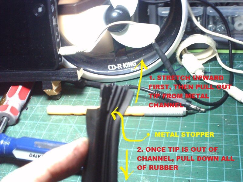

    Remove the original rubber by pulling up a portion of the tip outside the metal channel, then pulling down all of it. This is because there is a metal stopper near the top end.

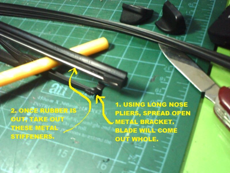

    On the NWB, remove the rubber by spreading the metal "fingers" that are stopping the the rubber from falling off.

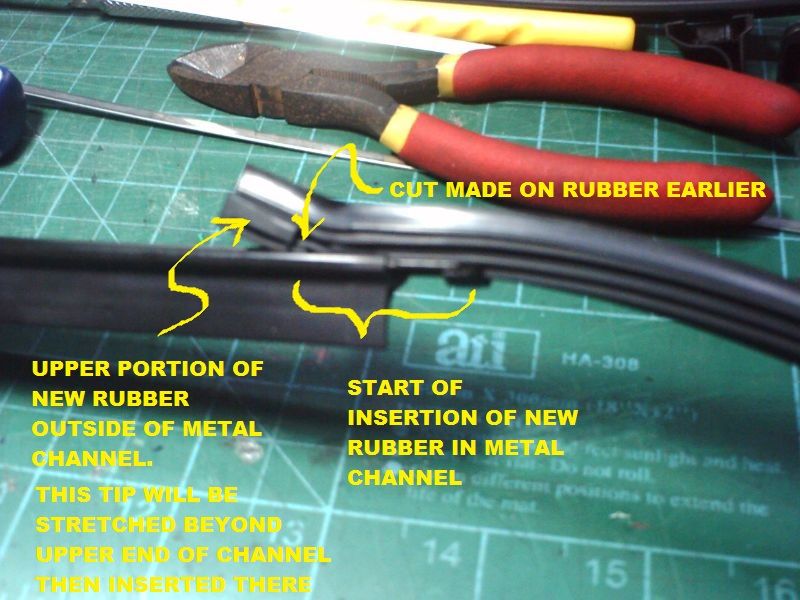

    Remove the metal stiffeners from the NWB rubber and make a cut same as the original rubber.
    Insert the NWB rubber into the original metal channel with the cut tip outside of the channel initially. Pag dating sa top ng channel, stretch it over the tip and insert the cut portion into the top channel.
