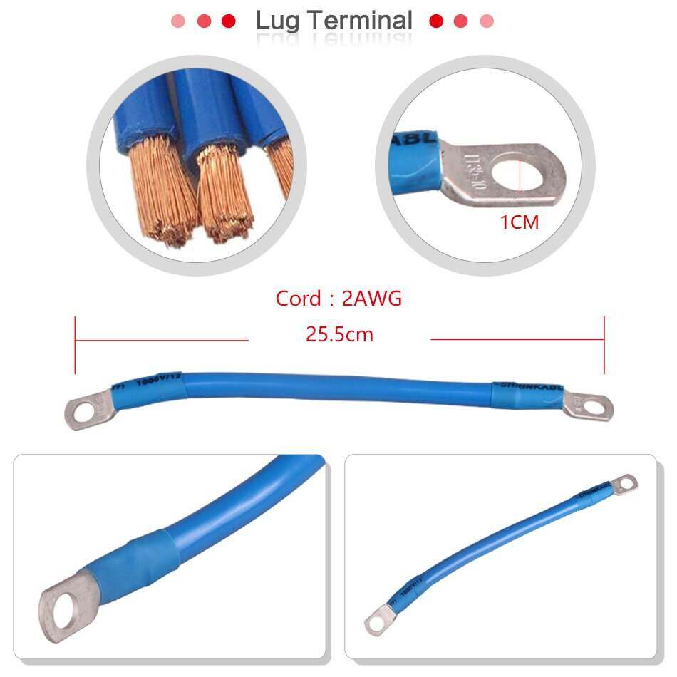

    Just make sure makapal yung cable na gamitin between the bolts, reminded me of a solar battery cable or old car battery cable.
    Attached Thumbnails Attached Thumbnails 7f81caa82984fbf7b0426311abbaf407.jpg_q80.jpg
    2,452
    #25
    Quote Originally Posted by chris_d View Post
    Yes, that's very true. Mataas amperage ng car electricals because the voltage is low.
    Jan 2016
    6,771
    #26
    Yes, most owners have already bought the 10cm 25mm2 wire with lugs for emergency fix.
