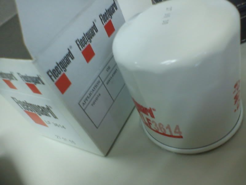

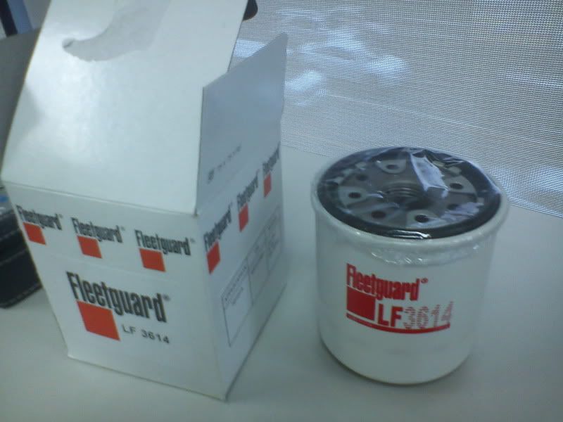

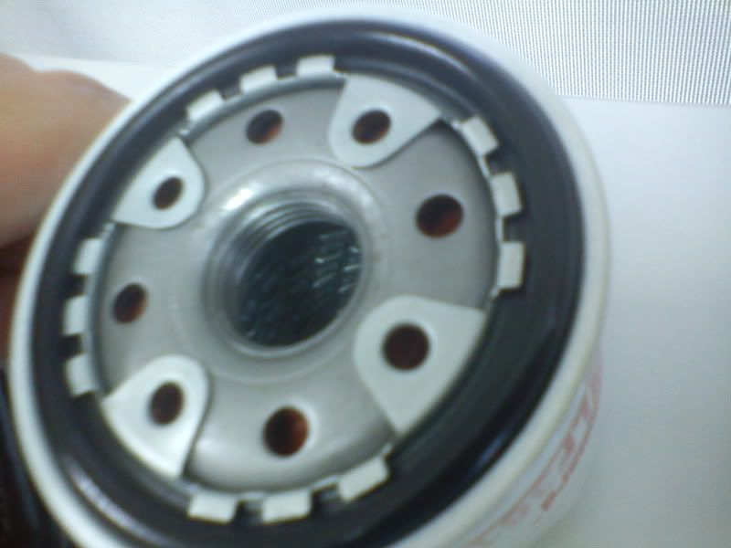

Doesn't even look like the old design. Looks more like a rebaged China made Toyota filter.
Someone tell me I'm wrong, which you guys know by know is not to often.
I fear it's this one one the Left on the inside which I have already shown is one of the worst filters that's out there, second only to the VIC. But it does have a metal center tube so who knows what the heck is inside it???????? I see it also has no country of origin.
Will it still work, oh I'm sure it will, I would be very curious to see what it looks like on the inside. Probably no better or worse than a OEM filter. But probably even worse.
Also know real fleetguard has a orange anti drainback valve.
Feel free to run it, cut it open if you can after you use it. I would not keep it on any longer than 5000klm or would just get another brand.Last edited by dvldoc; March 22nd, 2012 at 11:21 AM.
March 22nd, 2012 11:20 AM #1590
Thanks for the overview. I'll use it on one of the cars for the standard 5,000kms then cut it open on the oil change and post the update here.
