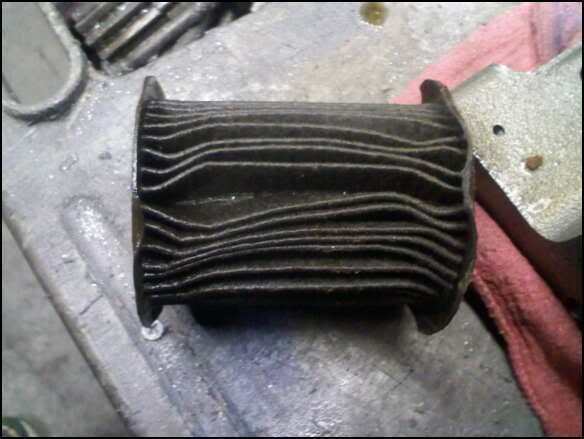

    I did not know they carried the orange can of death there to lol. FRAM is utter garbage only there very high end filter has synthetic media.
    The orange can ones right down to there mid level ones all suck. The extended guard is the only synthetic media filter they have. Frams filter media is well know to collapse rendering it usless as a filter since the oil goes unfiltered. It also like to come apart at the seams.
    Friends don't let friends use Fram, Here is a example of a collapse one, Many pending lawsuits for this little issue.

    YUP!! FRAM is a bit common in the Manila area. Good enough I saw the bad results of the FRAM so I went with baldwin and now I shall try fleetguard. Thanks for the reminder and 2nd motion of my findings
