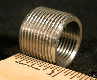

    This is the adapter I use to convert the kits 3/4 16" thead to a 1-16" thread, You just screw it on.
    Now here's the deal you can just get this adapter above if you already have a 3/4 16 thread and have 8" of clearance and put a LF9028 or BD7317 directly on your vehicle. Would work on things like the TD42, TD27, Ford Everest ect ect. Your not going to fit it on most cars due to the space requirements without getting the full kit.
    A competent machine shop could make this adapter for almost any size filter thread. It allows you to use a much larger and better filter.
