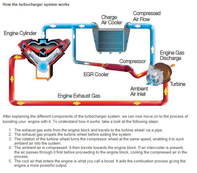

borrowing a photo from a recent article in autoindustriya.com...Getting to know the Turbocharger
the real deal in EGR blanking or blocking? it's item number 5, the cool air that enters the engine called "BOOST". you need that cold air to have more efficient combustion and more power.

With a sufficient airflow to an intercooler with a large enough surface area, the drop in air temp entering the combustion chamber plus the positive pressure provided by the turbocharger is sufficient to provide the boost in power. I think berrima diesel will allow you to dyno the vehicle prior and after work is done by them (if you have them block the EGR). The EGR cooler (not all vehicles have this) is placed to cool the hot exhaust gases that are being recirculated back. Otherwise, it will just counteract the cool air being chilled by the intercooler.
The cooling happens as ambient air is passed through the intercooler after being pressurized by the turbocharger. This is where the increased power comes from (forced induction plus intercooling)
The egr cooler just cools the insanely hot exhaust gases before mixing it up with the cooled ambient air.
