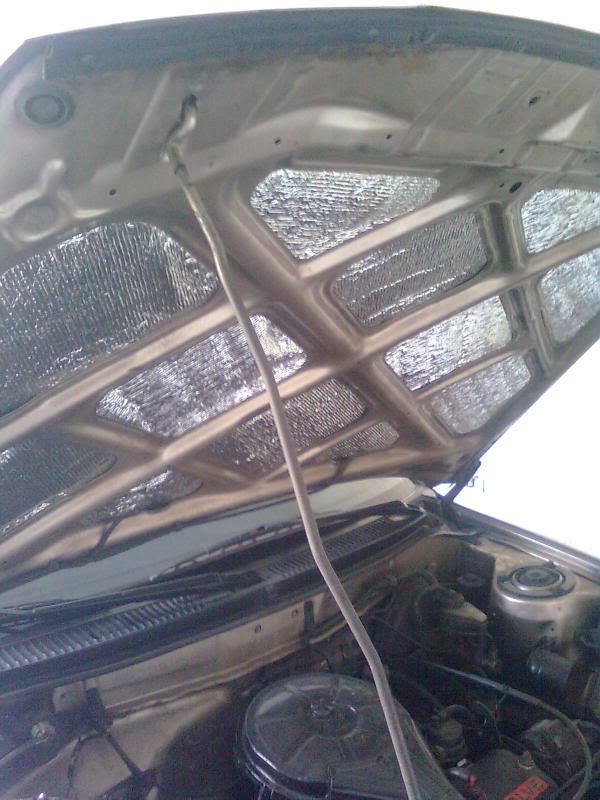

    I hope this will help to the get the idea for additional cooling system purposes.
    Hehehe... Classic Style...
    DIY wrap car aircon hose
    http://tykoh88.blogspot.com/2009/10/...rcon-hose.html

    ^Kung wala pang bonnet insulator sa sasakyan, makakatulong nga yan.^

    Yup... correk ka dyan boss...
    I also include DIY wrap car aircon hose link (not installed at Cruze), para may idea paano gagawin...

    Thats good also, nagawa na ni broMarlboro yan sa Cruze nya, sa Forte ko nagawa ko na din...malaking tulong talaga....

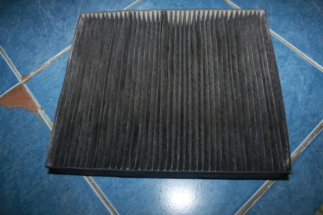

    [quote=mtbjr;1689452]Visited Chevy Pasig yesterday because of the cooling problem of my aircon for the 2nd time since I got my unit last NOV 2010. Sir awallit had my air filter cleaned last DEC 2010 and it returned to normal, but cooling problems returned for 2 weeks now so I had it checked. Daily driver from Marikina to Makati via EDSA & C5 kaya siguro ganun kabilis dumumi ang filter kahit naka-on ang air circulation.
    Sobrang itim ng old air filter and they advised me to replace it since nilinis na yun dati, free labor pero I paid for the air filter at 845php. Puwede kayang ibabad ito para pumuti uli siya so I can reuse it? I plan to canvass this weekend sa Banawe para may reserve na ako.
    Yup thats right, we should find that store who sells this pollen filter at a lower cost so that we can DIY it when its all dirty and black. this filter is good for another 5000 kms pa din mga sir. submerge it in water with a mild powder detergent for a few minutes and give it a gentle shake to loosen up the dirt then rinse with clean water, dry it under the sun then its good to go for another 5k kms and you can dispose it after.

    Alam nyo ba micron capacity ng AC filter?
    Kapag nilinis at ikinula sa ilalim ng araw, lumalaki ang micron capacity ng Filter...sa paningin natin, ok lang, walang pagkakaiba, puputi ang filter sa paglilinis...pero ang pagsala nya sa dumi, doon yan magkakatalo...di natin makikita ng bare eyes....
    kailangan,either ORig o replacement, pareho sila ng micron capacity....
    Ayaw natin na malason tayo ng usok galing sa ibang sasakyan....
    well, its just me, di advisable labhan ang ac filter. bugahan ng pressurized air ok pa...pero ibabad sa tubig then patuyuin, ayaw ko.

    Di pwede i wash ang aircon filter. Actually mura na yan at 845 pesos. Sa Honda at Hyundai nasa 1.5 to 2k yung aircon filter
