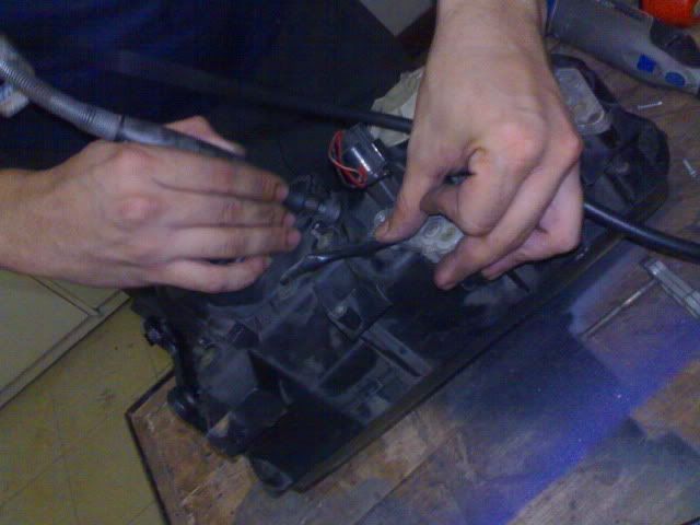

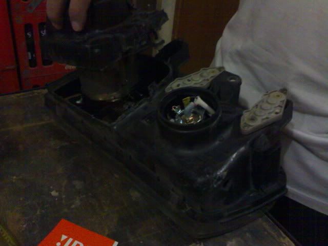

for a more defined headlight cut off, us projector housing users can do a projector lens retrofit. we currently use spotlamps and this causes a lot of glare to oncoming traffic. i'm tired of the curses and flashing of lights. hehehe
i will update this thread of the progress of this project.
a set of delica headlights were used c/o marlon/exceed and was ripped apart by rocky of mach2 (salamas sobra sa tulong!!!)
pics below..

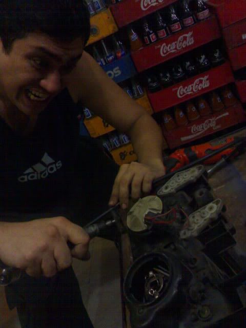

a dremel tool was used...
"Aaaaaaaaaaaaaaaaaahhhhhhhhhhhhhhhhhh!!!!!"

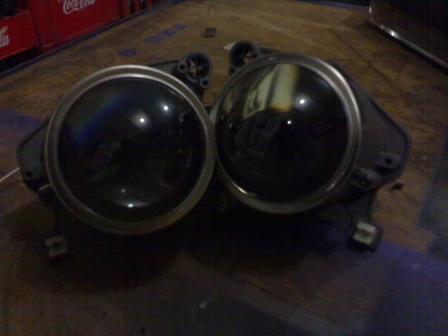

one done.
tadaaaa!

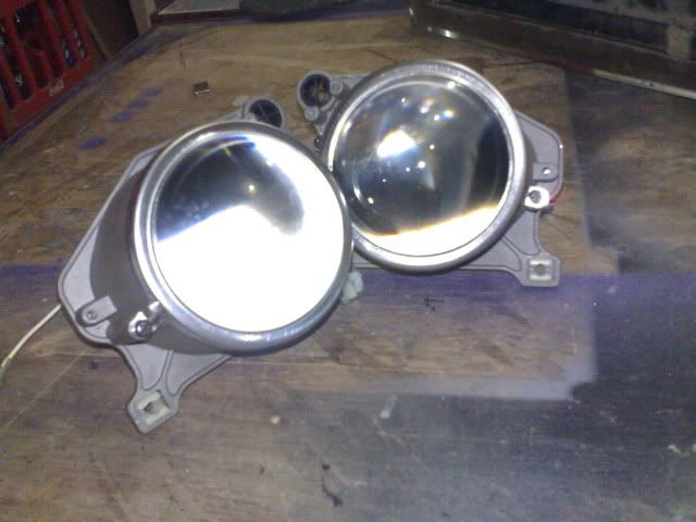

2 done. beautiful
tools used: dremel with cutting tool.

next in line is:
1. fixing the cut-off of the lens since these projectors are from a right hand drive vehicle. yero and steel epoxy will be used.
2. mounting with adjustability
