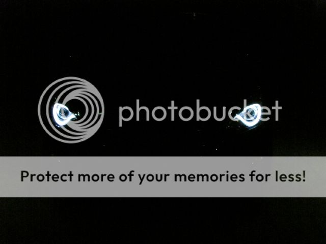

Vehicle specific DRL/fog light assembly for Hyundai Accent 2012-13. Dual intensity output for DRL function and parklight/driving light function. Complete with auto module and wiring harness
