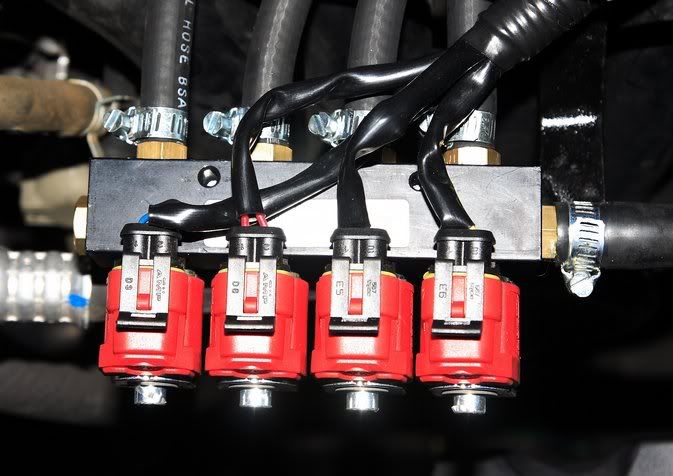

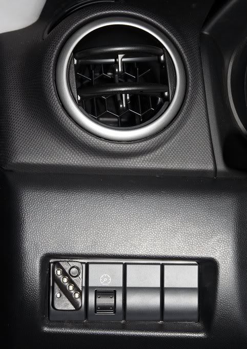

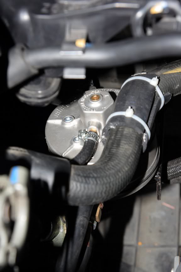

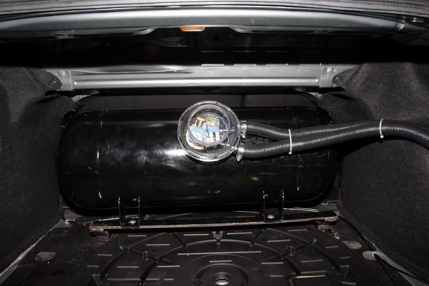

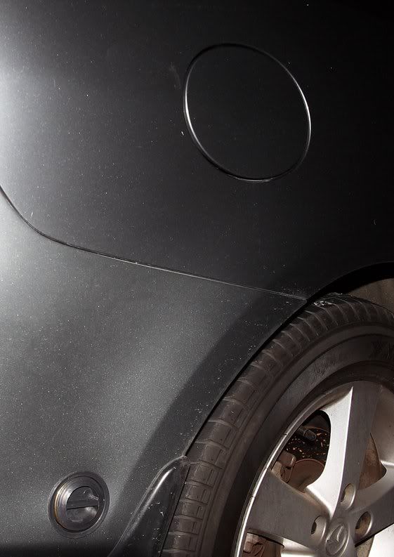

    I had my Mazda 3 converted and picked up last friday.
    So far so good. The power seems to be the same.
    I opted for the 60L cylindrical tank since I didn't mind loosing about 1/3 of my trunk space to the tank.
    GreenFuel lifted the tank a bit so I can still remove the plastic cover and spare tire as seen on the picture.
    I also didn't mind putting a hole in the bumper for the refueling plug
    I then had the switch/gauge placed on the left most part so I can see it and the steering wheel doesn't block the view.
    The Injectors are placed on the same spot as GH's M3.
    The Vaporizer was placed in the different spot from GHs M3 according to Mike. Its deeper.
