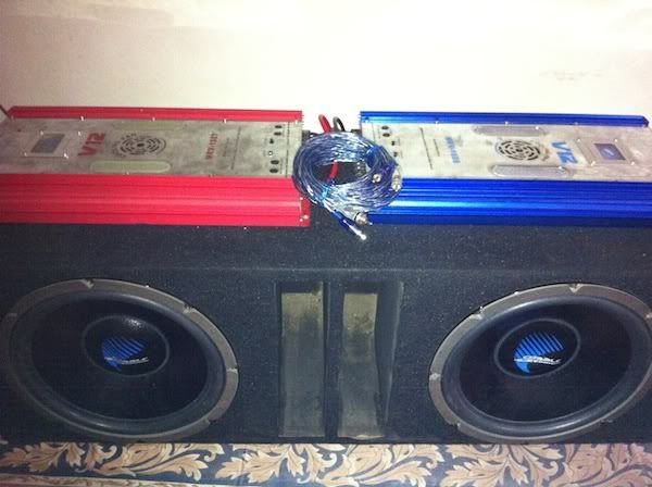

    2 - 12" DVC "OC12DVC"
    1 - V12 MRV1507
    1 - V12 MRV1608,
    Panu po ginawa to?

    meron nga po ako sir niyan bali nakakabit na lahat, stock palang po yung HU ko which is Pioneer(hindi ko matandaan yung model nasa pagawaan kasi yung sasakyan ko) and the other speakers, wala pa po akong seps and others, bali yan palang yung nabuo ko, may massugest po ba kau sakin sa pag tono? didipende pa din po ba yan sa HU ko? wala pa pong ibang dinadrive yung amp kundi yung tig isang sub, hindi ko kinokonekta yung mga stock na speakers sa amp dahil baka masunog at masira. Naka ported box po ako sir. Thanks po.

    A, yung isang sub po ba, ang nag da-drive is yung amp na red or blue, or, yung isang amp, sa dalawang sub, naka bridge po ba? Madali lang po i tono yan, just figure out how you do the wiring from amp to sub, if yung isang amp lang na red ang ginamit mo, say yung isang sub, nakabridge yun sa 1&2 channel, and the other sub is bridge on the next 3&4 channel, from head unit low output, sabihin natin na meron syang output para sa subwoofer signal, you use a pair of Y rca to connect it to your 4 channel amp, then, as first, check the gain of your amp, set the filter to low pass, all gain, frequency, or bass boost levels must be zero, play test CD to your head unit, set the volume level of your head unit to 2/3 of the total volume, if you hear a distortion in your speakers in front, turn it down slowly until the distortion is not heard, then go to your amp, for the gain on the first 2 channel, turn it up slowly until you hear a distortion on first sub, turn down a bit, to normalize its movement, if you want hard bass, turn your frequency knob as high as you like it, if you hear distortion, turn it down, then bass boost, normally, you dont need it if its loud enough, and if not, set these to 12db. Same thing you do to the next sub..

    bali sir ang connection na ginawa ko dyan, red amp to 1 sub connected to ch3&4 blue amp to 1 sub connected also to ch3&4 nakabridge po siya parehas, so i set the both amplifier to low, ang balak ko kasi yung channel 1&2 of both amplifier sa front and rear. ok lang po ba yung ginawa kong connection? or malaking mali? hehe.
    *sir tanong ko na din po medyo naguguluhan lang po kasi ako dun sa dalawa kong amp, yung isa nakalagay, "MOSFET WAY X-OVER" at yung isa po "MOSFET 3 WAY X-OVER" ano po yung pagkakaiba nung dalawa?
  10. #260
    Mas maganda siguro dito is yung isang amp, gamitin mo sa subs mo, and the other one to your seps or coax, in this way po, mas maganda ang magiging set up nyo, and i think, magkaiba din ng power ratings ang dalawang amp nyo, so hindi po parehas yung work nung dalawa since their having a different power supply, on the other hand, power efficient pa kung gagamitin mo is yung isang amp sa dalawang subs, because its pushing only low pass filter not a low and high pass option, maiinit sa amp ang ganitong set up ng amplfier, driving two different filters, and not guaranty a good and long last install.
